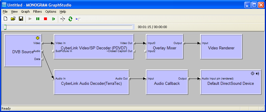

Pro: http://i.imgur.com/MXfE7.gif
TE: http://i.imgur.com/wWWbF.gif
I tried to match TE's setup to Pro's, but couldn't (note the video renderer). How can I make Pro use Video Renderer Alpha too?

Is your Pro screenshot showing a filtergraph that is supposed to be overlay? Actually it isn't, because the Overlay Mixer filter is missing. The filter graph should look like the one below. Probably connecting the Overlay Mixer failed, so DVBViewer fell back to the system default video renderer, which is the VMR 7 in a kind of legacy mode. Under XP it also tries to use overlay output in this mode, if available, but without color controls.
Looks like overlay is broken in your PC, most likely due to your graphics card / driver, and nothing can be done about it in DVBViewer. In order to verify that the Overlay Mixer doesn't connect, try to build the should-be filtergraph manually in GraphStudio.

I used GraphStudioNext v0.4.9.0 (forgot to mention its version) and took a screen shot/capture to compare: http://i.imgur.com/EYULg.gif ... So overlay mixer vanished when I get pink screen. Hmm! How do I manually add the overlay mixer in this program the next time it happens? I have never done that before and can't figure it out with the current working one.

You can't add the Overlay Mixer behind DVBViewer's back in a remote graph. It wouldn't work, because DVBViewer needs a reference to it.
So, in order to reproduce and verify the issue, I would try to build a "stand alone" graph with the same video filters in GraphStudio. Insert the DVB Source, Cyberlink Decoder and Overlay Mixer (Graph -> Insert Filter), then right-click the source filter's video output pin and select "Render Pin". That's how DVBViewer builds the graph.
If the Overlay Mixer doesn't connect, it is not included in the resulting graph, which means, some basic requirement for using it is not fulfilled, e.g. because overlay output is not available or it gets an error when it tries to use the underlying DirectDraw functions provided by the graphics card driver.
Please note: A graph with the DVB Source as source filter won't play anything in GraphStudio, because the DVBViewer Filter expects data via a proprietary interface. If you want to check things with a graph that plays a MPG or TS file, use a file source filter like Haali Media Splitter, that prompts you to select a file when you insert it.
