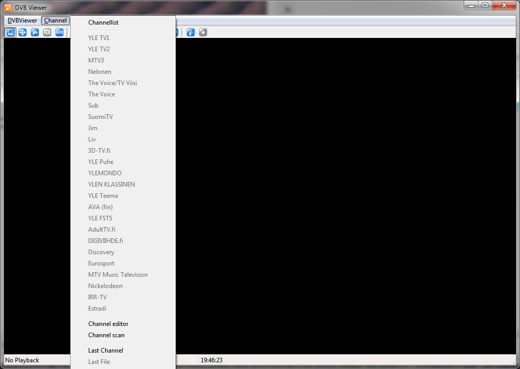

I had a BSOD of Windows 7 (EDIT: well DVBViewer actually) yesterday, while I was closing DVBViewer (latest beta-version). When the windows came up again, I started DVBViewer and to my surprise the window was black. I could see the channellist as it used to be, but the channels were all grey, as you can see in the attached picture. Support.zip also included.
I have uninstalled DVBViewer Beta, and installed the latest release of DVBViewer (4.9.6.20), but it didn't help. However I left the settings and the directory there.

- There are lots of other icons and menuitems greyed (i.e. not clickable), e.g. under File --> Record Video, Timeshift, Stop timeshift recording, Teletext, pause.

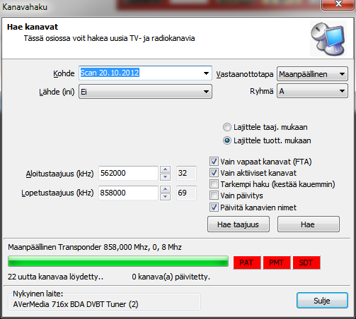

After I removed DVBViewer completely, I also lost my tuned channels.
I tried to scan for the channels, but neither 'hae taajuus' or 'hae' (probably "scan frequency", "scan") gave any results.
Then I noticed that the starting frequency was something very low, channel 2.
I increased the frequency to 562000 (channel 32) and started scanning, and immediately there were lots of channels found.
Attached is the picture after the scanning was done.
Channel list remained empty, but then I realized that I had to build the favourite list again.
So the problem does not exist anymore, but I'm still wondering what the heck went wrong in the first place and after that.
- DVBViewer closing caused whole system crash
- After restart DVBViewer didn't show any video or audio, and the channel list was grayed (as well as many other menuitems)
- Total uninstall + reinstall did not help immediately
- Scanning for channels didn't seem to work immediately
- only after changing the starting channel, the scanning was completed
- after updating the favourites, everything was quite ok.
