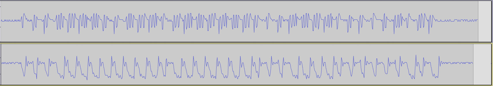

vladaepro Posted January 15, 2013 Author Posted January 15, 2013 After exchanging few messages with retro (thanx again man), and testing Windows 7 64 bit, i have realized that it can be only faulty device or diseqc incompatibility. As sar diseqc is not quite cheap (about 30 eur here) i have borrowed oscilloscope from friend in order to check is my BGT card even sending diseqc commands. Hopefully, i have captured commands out from card when tuning to channels in DVBViewer. Just, i must admit the signal itself don't look quite good to me (as for my cheap diseqcs either), but i'm guessing the better device (sar) can handle such garbage... Here the visual comparison attached - upper one is from TT S2-3200, and lower from BGT 3630. Ideally, diseqc bits should look like intervals of 22khz tone and delays - upper scope looks like that but i wouldn't say the same for lower one... Quote
vladaepro Posted February 18, 2013 Author Posted February 18, 2013 (edited) Hey Just want to thanx you guys once again for effort and patience, as i got my setup working - SAR 411 finally arrived, and working like a charm, just out of the box! Viva 'made in Germany' Edited February 18, 2013 by vladaepro Quote
