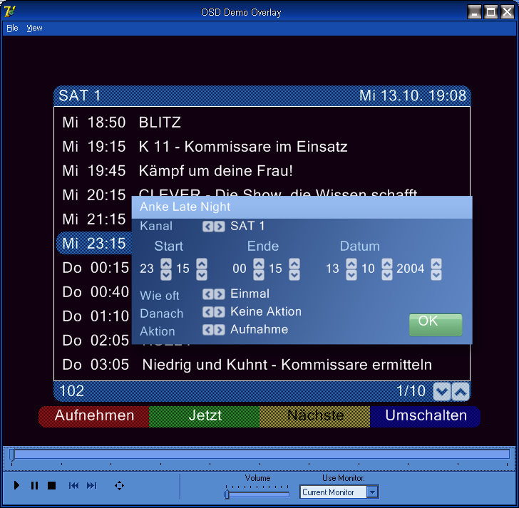

Guest Lars_MQ Posted November 9, 2004 Posted November 9, 2004 Well we have a recording dialog Don't be fooled by the simple look of the windows, these are fully skinable like in the newOSD. I use it only for development, because I spend first time in programming and then make it nice looking Also it will support languages like everything else inside the DVBViewer. AND everything is mouse, keyboard or remote control accessible. Quote

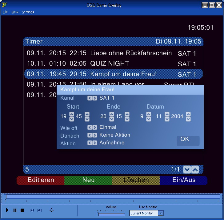

Guest Lars_MQ Posted November 9, 2004 Posted November 9, 2004 we have a programmed timer window. Here you can see the clock in the upper right corner you turn on and off independently from the current shown OSD. Thats the new stuff besides the known windows, which will have all extended functionality. The weather and timeline are currently reworked and integrated into the osd. And media management with a integrated fast and lean sql database is also working for now (well partly ). The systems windows, I have to ask christian how and if I can obtain the data. Then the displaying will be easy. The timeline, well it's fully skinable but because of this it will be difficult to color the event bar by event type, I have to see if there is a way to do it, without performance loss... Quote
