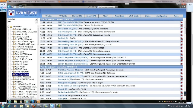

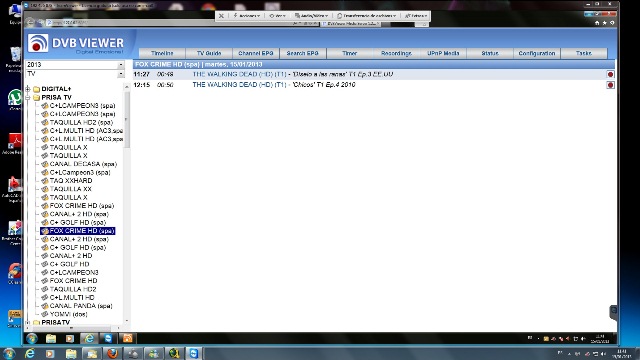

JordiV Posted January 14, 2013 Posted January 14, 2013 I have a problem with the EPG from recording service, on channels that are not HD programming shown me, but the channels are Sd if I show programming, you know where is the fault? thank you very much. my cards are; Hauppage TDT channels Skystarhd2 for a satelit support.zip

JordiV Posted January 15, 2013 Author Posted January 15, 2013 ..you'd better give an example of an HD channel without EPG and the corresponding SD channel with EPG. Yes,look

Derrick Posted January 15, 2013 Posted January 15, 2013 ..never mind, I've already found the transponders. There's nothing wrong. The EIT only contains present/following. For the SD channel apparently mediahighway 1 is used to list the complete EPG. Though I can't tell whether the HD channels are missing in mediahighway or a different transponder has to be added or they have changed to mediahighway 2. DVBViewer GE which is always up-to-date concerning EPG doesn't show the complete EPG for the DIGITAL+ HD channles either..
