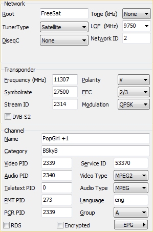

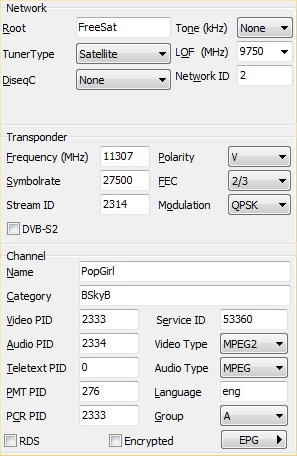

I looked once before but it was off-air so I couldn't be sure but I just checked again and it's working fine here on FreeSat. Here are the settings for both channels:
Edited by SimonP
