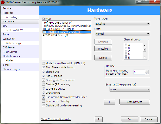

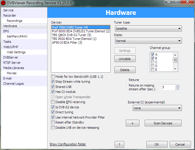

Griga Posted April 28, 2013 Posted April 28, 2013 As I can see on your screenshots, you have set "Shared LNB" for all tuners. I guess this is not correct. The Shared LNB option must only be used for tuners that are connected to the same LNB with a two- or four-way-splitter (not a switch!), so they can't set polarisation, DiSEqC and/or frequency band independently, or with other words, the tuners can only receive transponders with the same polarization, DiSEqC and frequency band at the same time. If Shared LNB is switched on the RS considers these restrictions when selecting a device.

gqsun Posted April 28, 2013 Author Posted April 28, 2013 After unticking all shared LNb check box It worked as expected. Now it has became an issue of the definition of this option, because as you can see I have multiple tuners connected to a Splitter and then to a single polarization lnb
