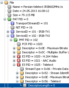

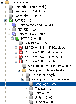

Usually it is part of the teletext descriptor within the Program Map Table (PMT), which is one of the broadcasted Service Information Tables (SI). There are teletext descriptors in your file - otherwise receivers would not recognize the streams as teletext - but they are empty. I think it is not so important because mostly people will use localized DVB-T receivers and TV sets that are selecting the correct character set by default. However, international software like DVBViewer needs the language information.
You can see it in the TransEdit Analyzer (download from the DVBViewer Members Area, please read the installation instructions in the ReadMe). The manual contains an introduction to SI tables.
The attached Analyzer screenshots show the PMT of a German DVB-T channel that contains a complete teletext descriptor including the ISO language code "deu", and for comparison the PMT of a Persian channel. The third screenshot shows a part of the Persian Event Information Table (EIT) containing EPG data. Here the language is correctly specified as "ira". However, since the Persian EPG uses Unicode character coding (UTF-8), the character set is no problem. DVBViewer would display the EPG correctly even without the ISO language code. Unfortunately teletext is a very old system and not designed for using UTF-8.
