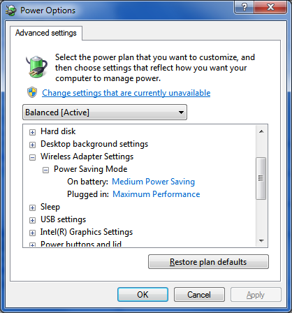

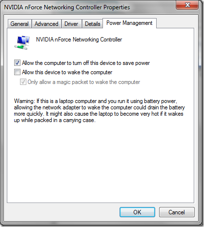

Gioxy Posted September 21, 2013 Posted September 21, 2013 About "sleeping/hybernate" modus, I have disabled them as we always do with all our clients and servers I read with more attention your replay: sorry for the misanderstunding, I wasn't referring to O.S. options, but instead to the w7 advanced power options specific for the cards AND/OR cards own powersaving options (they may have a specific tab in device manager property window), ie, respectively: ...if powersaving is totally disabled in both places then most probably the problem is in the driver... Quote
IT-KSSO Posted September 25, 2013 Posted September 25, 2013 Hello everybody, My update of the war: 1. The drivers of the Digital services tvcard doesn't have any powersettings options (like the ones on the second picture from Gioxy). 2. In the advanced power options in Windows 7 there ia a power setting for the PCI Express bus. I have set this option to "Aus(off)" but it didn't make any diference. Yesterday I tested the fourth DuoFlex card and the same problem. 3. In contact with Digital Services, they think the drivers work but there is a timing problem with the PCI express bus. More news after some more tests. Thank you for the help. Jaume Quote
