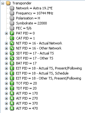

Griga Posted December 6, 2013 Posted December 6, 2013 Your sample doesn't contain a NIT for the actual network. Looks like the cable provider only broadcasts a NIT for other networks. Maybe it contains information about the actual network (the one you are receiveing), but it is flagged as a NIT for other networks. The scanner only reads data that applies to the actual network, of course. Usually it looks like the screenshot below. Read more about it here. Quote

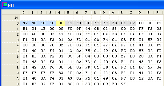

Griga Posted December 6, 2013 Posted December 6, 2013 Another thing would maybe change the information which define the nit table from other network to actual network in the .ts file... Would this be quicker ? Dunno how good you are in manipulating binary files... you can see it in the TransEdit Hex Viewer (right-click the stream in question in the Analyzer -> Hex View). The table ID for "other" NIT sections is 0x41 (first byte after the yellow one). The table ID for "actual" NIT sections is 0x40. It has to be changed for all NIT sections, which means, you have to find out where they start in the file, which means, you need profound knowledge about how a TS and SI tables are structured. And another drawback: It would require scanning the modified file. TransEdit is able to do it, but the scanner can't do anything with the results because there is no transponder list associated with a TS file. So... forget it. Quote
