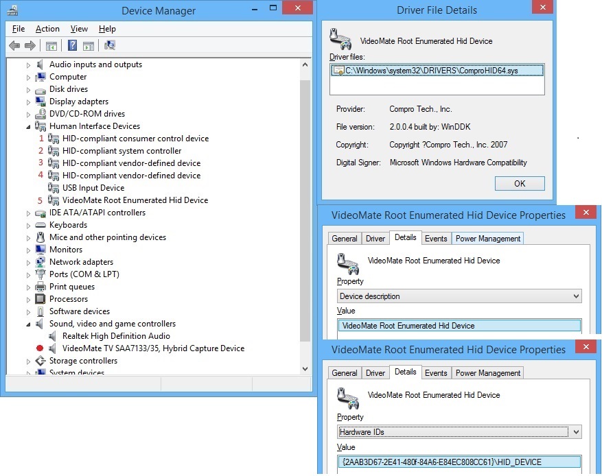

I installed just the HID (Human Interface Device / Remote) software from the CD that came with the TV card. After running ComproRemote.exe that had just been installed, five new entries appeared in the Device Manager / Human Interface section. All five are shown as "Working Properly". Please see attached picture showing the devices in the Device Manager, the device name, the device Hardware IDs and the driver.

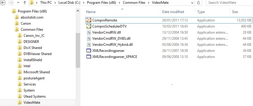

I have also attached a picture of the files installed by the Compro CD which includes the DLL files that were installed.
