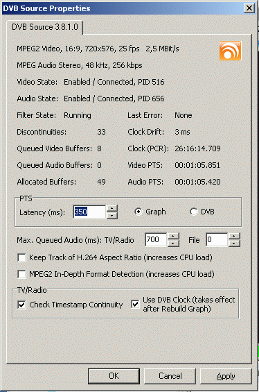

I also see from source filter immediate discontinuities after I start it. Clock drift also starts showing drift immediately, even its rather small, within first minute some 5ms.
I attach capture of the window, as you see more from it than I do.
I dont think problem is my puter, as all works and passes tests fine, receiver card I really cant test, unless someone kindly tells me of tools/softwares to see more of the cable-tv signal.
