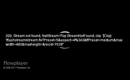

I have not been using flowplayer much in the last while since the Android App was released, but I have recently had my broadband upgraded, and I want to access my recordings remotely. However, I am getting an error in flowplayer
"200 Stream Not Found" and lists the descriptors of the playbeck settings.
If I click on the Direct stream, it plays properly in VLC, so the file exists. I have tried on the server machine, a local lan machine and via internet, so it's not a router thing. I have tried on Firefox and Internet explorer (explorer does not display the message, it justs shows the continuous circle). I have also upgraded to the latest version of ffmpeg.
Has anyone else encountered this error and if so have you found a cure?

Here is the full error message.
The version of Java is up to date and the RS is 1.29

Port is most probably not your problem. There is a port answering with http err: 200.
I d check two things.
Does recording 7639 really exist ? I guess yes, but still worth a check.
Is ffmpeg starting ? I tend to think this is your problem. No working ffmpeg, no stream.
Edited by mague
Recording is definitely there because it plays on the direct stream in VLC
This is the more interesting one - I think you have hit the nail on the head! I have had lots of little user right issues over the years with this version of Windows 7 (Professional) on both the HTPC and the RS server PC. Even though the only account on the machines is set up with administrator rights, there are still processes that will refuse to run if they are not run as administrator. For example, to run my EPG Collector, I have to set it up as a Windows system timer rather than from within the RS because it simply will not run.
To check, ffmpeg does not start in the Task Manager when I request the stream and thus flowplayer cannot give me the stream. I have now checked it on a Windows 8 machine with a Home licence and it works perfectly. At least I now have an explanation, and sometime I will learn how to convince the machines that the user with admin rights has the same rights as the Administrator user!
