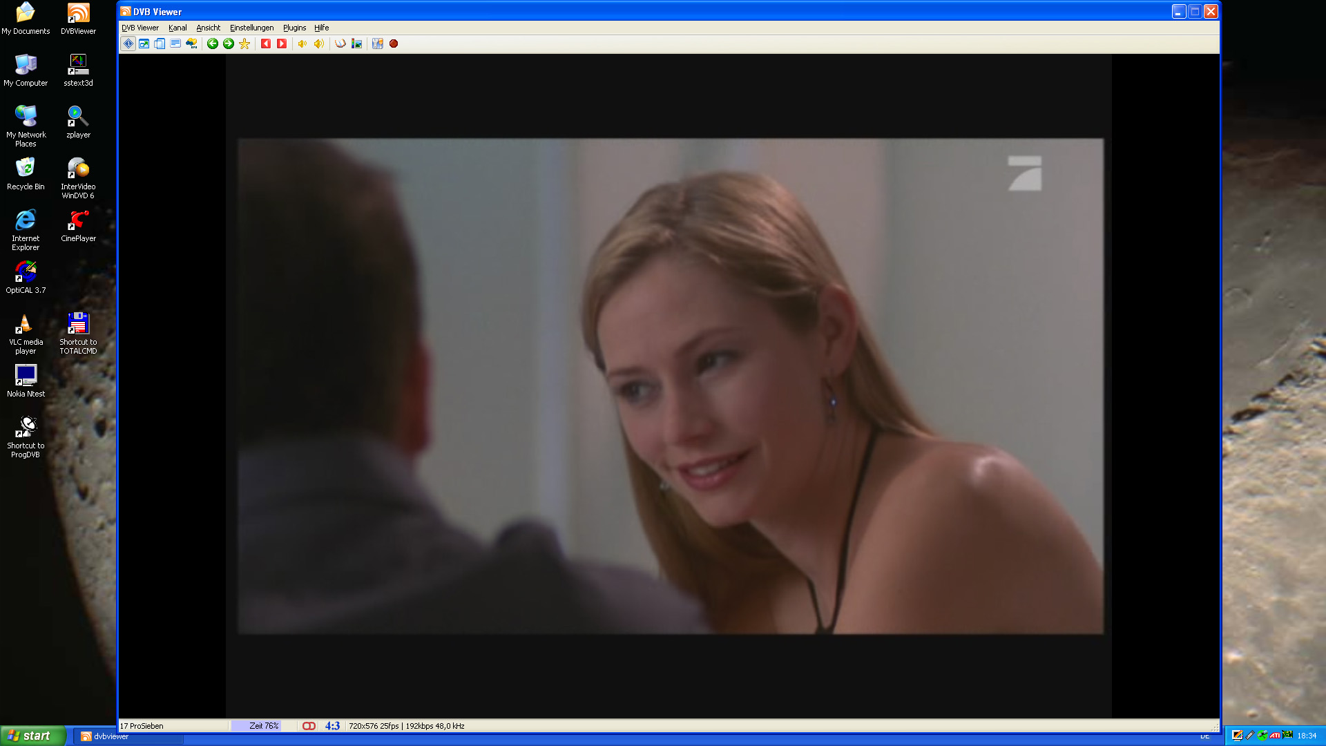

Ok, here is the screenshot, it isn´t fullscreen, but you can see my problem with black bars on all sides.
Hopeyfully you can read that in the bottom line is a 4:3. The aspect ratio is auto.
In fullscreen this 16:9 movie has about 60% of the screen :D

I´m seeking a flag for overriding the guessed aspect ratio.
Hm, it is really 4:3 since the black bars on the top and the bottom belong to the picture. Pro7 doesn't broadcast in anamorphic 16:9.
But I really don't understand your problem. If the width is once set there's no need to modify it, it fits for both 4:3 and 16:9.
Bye, Oliver
Well, we already had something like this with BBC channels (reported be Derrick). It happens if a 4:3 picture is broadcasted in a 16:9 container: The video headers say it's 16:9, but actually it's 4:3 with black bars at both sides (added by the broadcaster).
Ok, but this is a different thing: Here we have a 16:9 shaped screen plus a 16:9 picture in a 4:3 container - black bars added at the top and bottom. These bars are part of the picture and can't be removed without re-encoding the stuff.
So the 4:3 picture height (including the bars) exactly fits your screen height. The horizontal size is set according to the 4:3 aspect ratio reported by the video headers. That's why you get additional black bars at both sides. Since the top/bottom bars are part of the picture, no software will be able to recognize that it's 16:9 without analyzing the picture content - actually no software does it, because it's quite expensive.
Unfortunately there's only one solution at the moment: Using the sliders under Settings/ Zoom for manual adjustment - not very convenient :D . One thing that could be done in future: A one-click-option for (re-)storing this adjustment.
