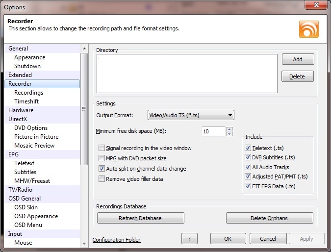

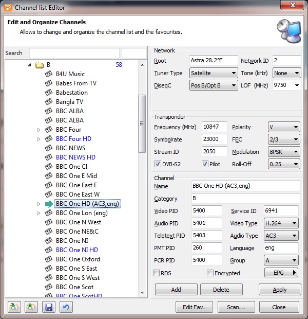

I've attached the settings I have at the moment under Options/Recorder and the BBC One HD channel information I have as well as information gathered by the support tool.

As seen on your right screen shot, you haven't checked "remove video filler data". So perhaps one recording is blown up by unneeded filler data. To save space (without loosing quality or anything else) I would use this option.

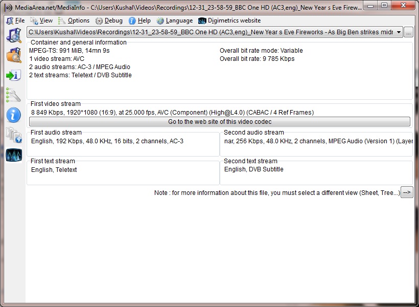

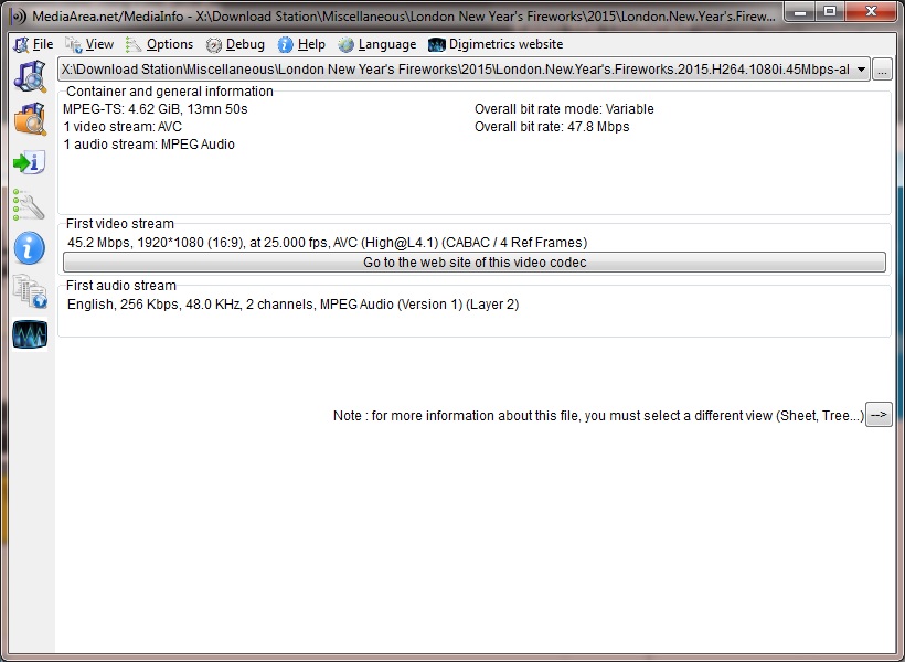

..use mediainfo and post the result.
See the attached files...
..well at last I understand. You're comparing a BBC HD broadcast with a feed. You'll never find these rates on DTH broadcasts.
