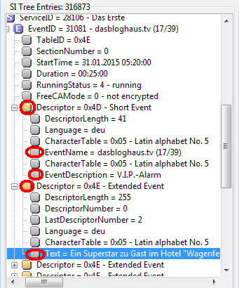

...and it depends on how EPG data is broadcasted.
The DVB specifications provide three textual parts:
(1) Event name: "How I killed your father"
(2) Event description "Episode 55 / 3 (forget it)"
(3) Extended event description: "In this episode a long and boring story finally comes to an end..."
That's how it is supposed to be used, and that's how it is actually done by most European TV broadcasters. You can see it in the TransEdit Analyzer:

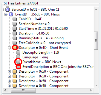

However, the British in their splendid isolation :) handle it a bit differently. This is from Freesat (Astra 28° East):
The event description in the Short (!) Event Descriptor is abused for telling a long story. It should be placed in Extended Event Descriptors. But there are none. There you are...
So fixing the resulting issues requires a re-assignment of data fields somewhere on the way from source to destination.
