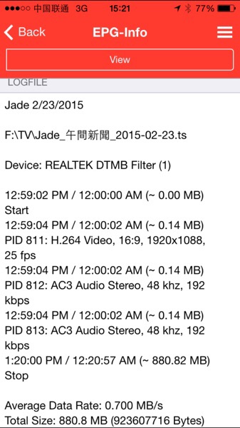

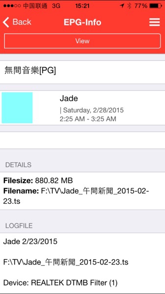

Paul Posted February 23, 2015 Posted February 23, 2015 Strange recording behaviour happens after RS upgraded to 1.30.1, the shows were recorded according the timer settings, but the EPG data on recordings appeared to have another show names which dated several days later. Install back to 1.29 will back to normal. I will attach support.zip later when I back home. Thanks!

Paul Posted February 25, 2015 Author Posted February 25, 2015 I changed "EPG Event ID usage on timer handling" from 1 to 0 in Recording Service Tweaker, the problem seems has been solved.
