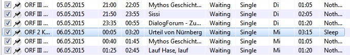

I had scheduled some recordings which would end at 3:15am, and then DVBV should send the PC into sleep.
Instead, DVBViewer sent the PC into Away Mode. For my machine, that means it's only turning off the monitor.

PS: I changed the end-time of the marked recording to 03:14am after I made the screenshot.
