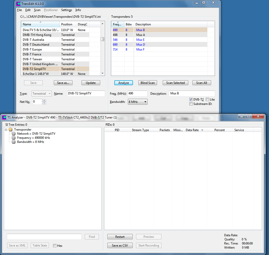

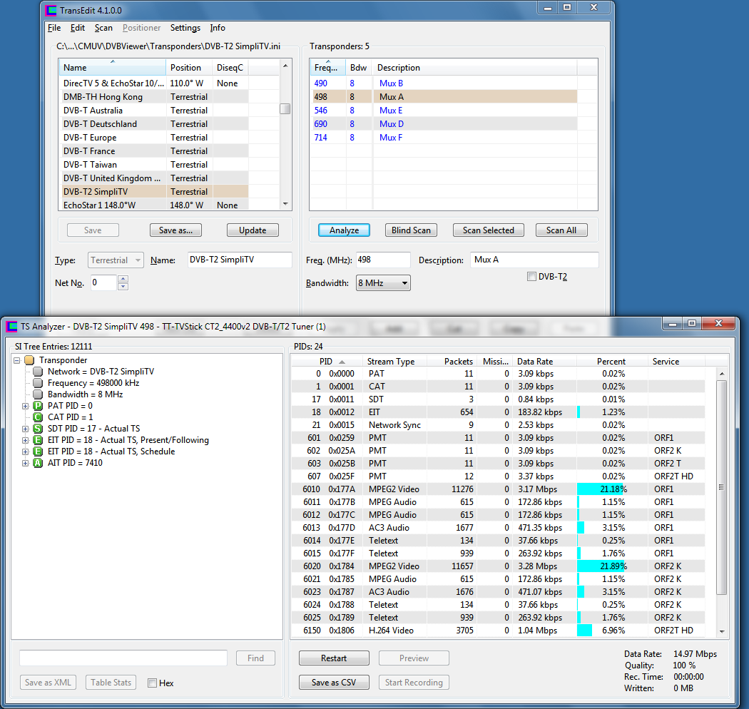

hurda7 Posted May 14, 2015 Posted May 14, 2015 (follow-up to http://www.DVBViewer.tv/forum/topic/55534-ci-mit-dvb-t2-aber-wie/) TransEdit 4.1 DVBViewer 5.3.2 TechnoTrend CT2-4400v2 (DVB-T/DVB-T2/DVB-C), driver 4.3.0.0 In TransEdit, I can scan a DVB-T-frequency and get all the information shown in the TS Analyzer. Scanning a DVB-T2-frequency (SimpliTV) comes up empty. For example: DVB-T 490MHz: DVB-T2 498MHz: At least reception-wise there shouldn't be a problem, I guess. Here's the hardware.xml: <?xml version="1.0" encoding="UTF-8"?> <settings> <section name="@device:pnp:\\?\usb#vid_0b48&pid_3014#20131128#{71985f48-1ca1-11d3-9cc8-00c04f7971e0}\{f31bcf3b-9623-4937-8228-bd895ba00b01}"> <entry name="UseHardwareFilter">1</entry> <entry name="StopStream">1</entry> <entry name="DVBS2">1</entry> <entry name="useMSNP">1</entry> <entry name="Name">TT-TVStick CT2_4400v2 DVB-T/T2 Tuner (1)</entry> <entry name="TunerType">2</entry> <entry name="Status">1</entry> <entry name="InstID">TT-TVStick CT2_4400v2 DVB-T/T2 Tuner 0</entry> <entry name="DeviceNr">1</entry> <entry name="Vendor">32</entry> <entry name="Priority">2</entry> <entry name="Tag">0</entry> <entry name="DeviceType">1</entry> <entry name="Groups">255</entry> <entry name="Retune">5</entry> <entry name="SkipComponents">0</entry> </section> </settings> Quote

hurda7 Posted May 16, 2015 Author Posted May 16, 2015 (edited) Well, Layer-8-error confirmed. I thought I had used different Substream-IDs, but I guess I forget to hit "Apply" before "Analyze". I retried with Substream-ID 1, and now I can get the TS-info. Crisis averted. Thanks! EDIT: Scanning the Transponder List in DVBViewer doesn't result in found channels, though. Edited May 16, 2015 by hurda7 Quote
Griga Posted May 16, 2015 Posted May 16, 2015 I retried with Substream-ID 1, and now I can get the TS-info. Thanks for your investigations. It's quite unusual to start with 1 (instead of 0). Nevertheless the TransEdit Scanner should be able to auto-detect it by using the according DVBSky driver capabilities. Did you try to scan such a transponder? Unfortunately I had / have no opportunity to test it. So I had to rely on the feedback from the DVBSky staff. They checked it with a test generator and confirmed that everything is ok, but who really knows about about SimpliTV oddities... Quote
hurda7 Posted May 16, 2015 Author Posted May 16, 2015 (edited) Thanks for your investigations. It's quite unusual to start with 1 (instead of 0). Nevertheless the TransEdit Scanner should be able to auto-detect it by using the according DVBSky driver capabilities. Did you try to scan such a transponder? If you mean hitting "Scan Selected" instead of "Analyze", I just tried that. Without SubstreamID being set, the scan doesn't show anything. EDIT: I noticed an oddity: When doing the scan with Substream-ID set, the moment the channels are being found, the Substream-ID-checkbox is unchecked, the ID-number-box(?) disappears and the frequency-field in the Transponder-list changes from e.g. "490 #1" to "490". Every subsequent scan without Substream-ID set is successful, even if closing and reopening TransEdit. Only after unplugging the stick and plugging it in again the scan fails without setting the ID. I have a screenrecording of this if it would help you. Edited May 16, 2015 by hurda7 Quote
