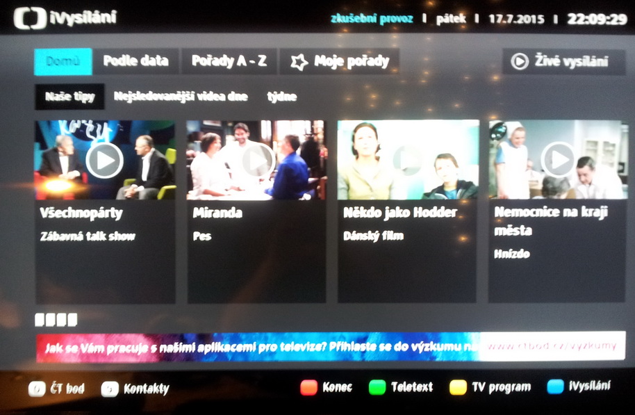

Derrick Posted July 17, 2015 Posted July 17, 2015 ..should be working. I don't use HBBTV on a pc and I don't have a smartcard for the czech channels but after scanningd 23E, 12363V with my Samsung smart tv I can watch all additional streams in good quality though the language is a problem Quote
