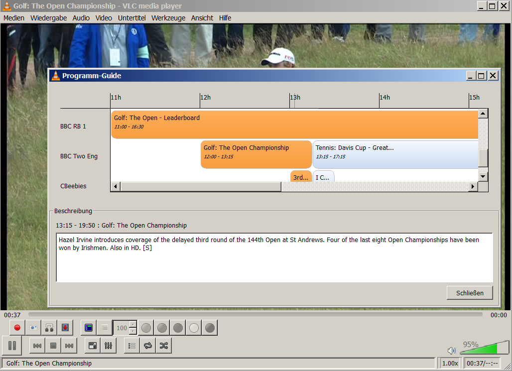

My5elf Posted July 19, 2015 Author Posted July 19, 2015 (edited) Which UPnP client is able to extract EPG data from a ts stream? Ask that your colleagues from NetStream plugin, I'm using VLC but also there's no EPG in RSTP streaming, don't make me to post more screenshots Edited July 19, 2015 by My5elf

Tjod Posted July 19, 2015 Posted July 19, 2015 Pleas describe you problem (what are you doing and what is happening) with the RTSP straming to the VLC Player post a support.zip I don't see why you can't use RTSP streaming instead of UPnP streaming. (I get EPG in the VLC player if I use RTSP streamin from the RS)
