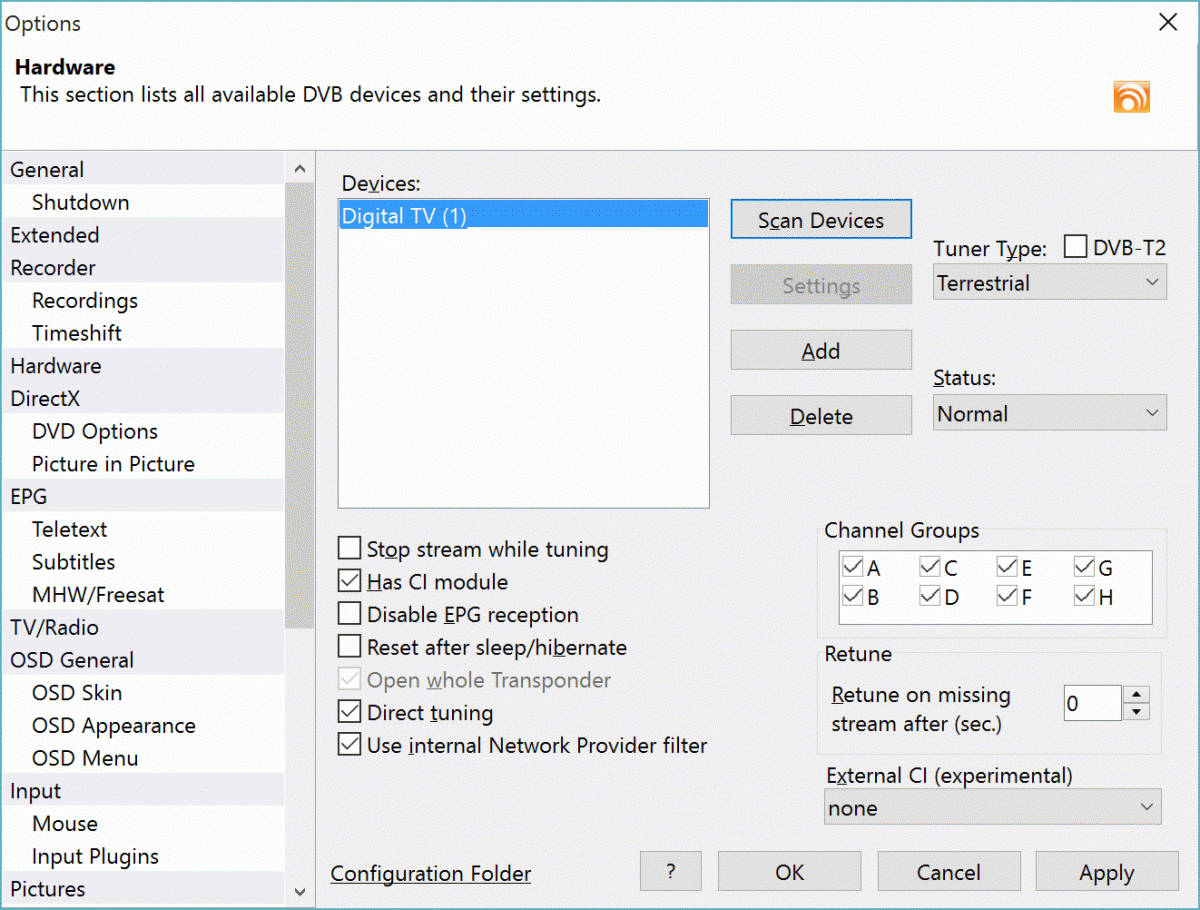

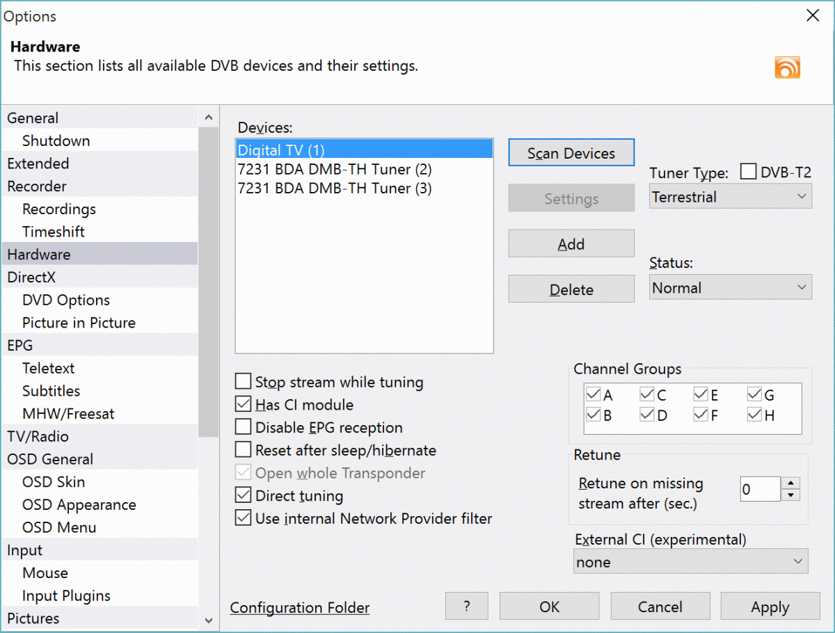

As said, I should see 4 devices on the device list. However, in Windows 10, every time I press the "Scan Devices" button, the result is not the same. I observed cases when there is zero, 1, 3, or 4 devices found.

Although probably not helpful, I attach the screenshots of inconsistent devices found when pressing "scan devices" for your reference.
