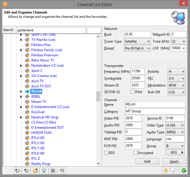

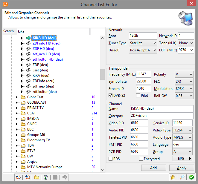

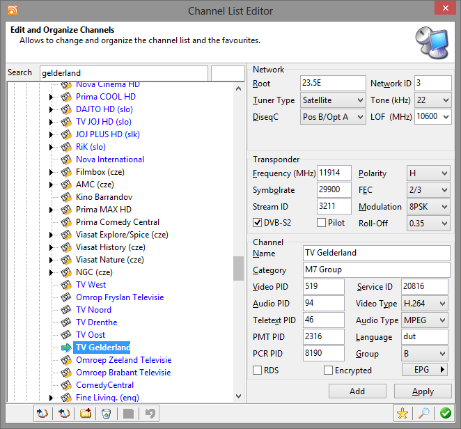

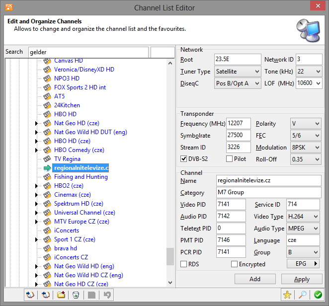

Phyxsius7 Posted February 28, 2016 Author Posted February 28, 2016 I have done the test you have requested and found differences between v1.26 and v1.32 regarding not being able to see unencrypted channels. What I have done: uninstalled v1.26 installed v1.32 disabled 'Has CI" *) Tried out a lot of unencrypted channels and found that some channels do not show video when chosen from a stopt position. These channels do show video when chosen from a already playing channel. I have made screenshot from 2 channels that do NOT show video from stop position and 2 screenshots from visa versa. Enabled 'Has CI" but this did make any difference from the above found statement. uninstalled v1.32 installed v1.26 disabled 'Has CI" All channels show video regardless if they are started from a stopt or already playing position. Enabled 'Has CI" same result (All channels show video regardless if they are started from a stopt or already playing position.) ------------- uninstalled v1.26 installed v1.32 renamed tbsCIapi.dll to tbsCIapi1.dll and created a copy and renamed it to tbsCIapi2.dll, both files (tbsCIapi1.dll & tbsCIapi2.dll) in the same directory as the original (tbsCIapi.dll). This did not effect the result in the above test *) ALSO encrypted channels still do not function. uninstalled v1.32 installed v1.26 All channels show video regardless if they are started from a stopt or already playing position or are encrypted or unencrypted. Hope his helps. Kind regards, Phyxsius7
