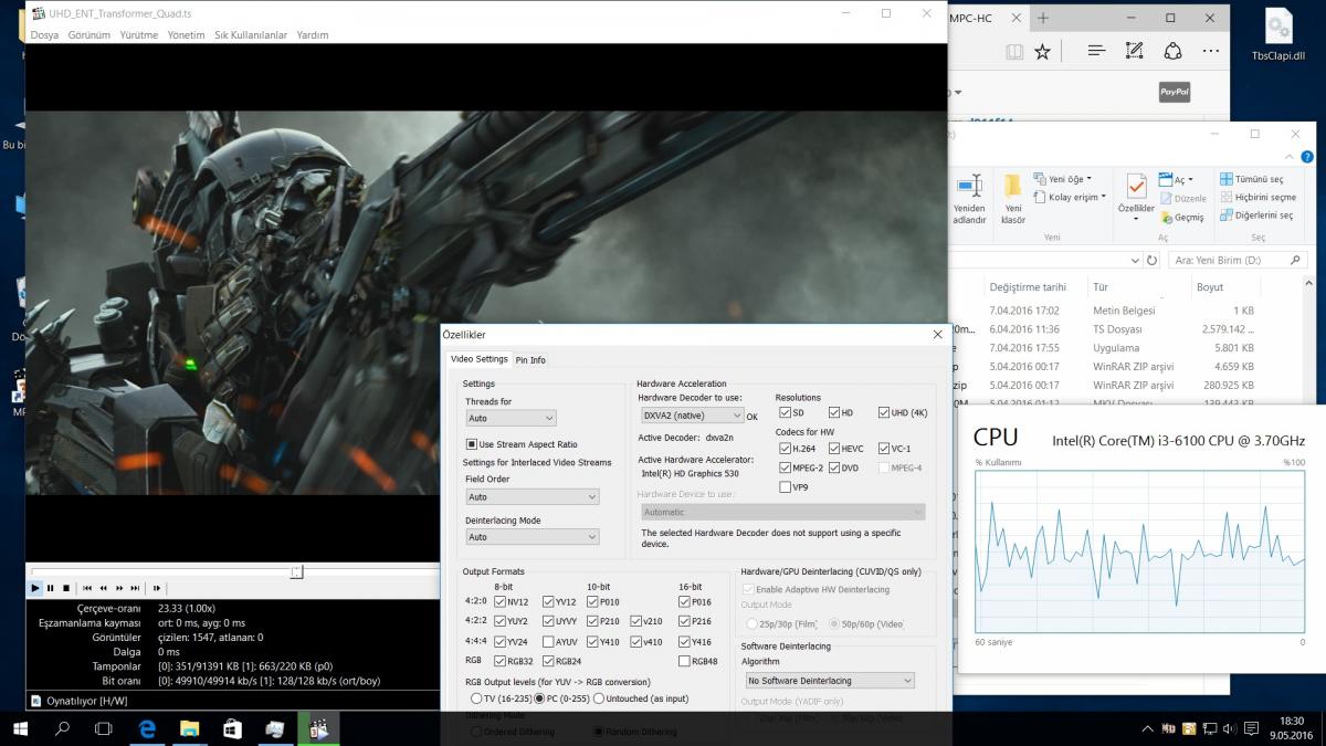

I have Skylake CPU with İntel Graphics 530. And I play the same HEVC file with MPC-HC without any problem with LAV Filter. I also tried various kind of Renderers MadVR was one of them. MPC-HC does not crash anyway.

You are using the same LAV Filter version 0.68.0.29 (32 bit) in MPC-HC for testing?
In MPC-HC DxAV is shown in the LAV Filter options as working?

I attached 2 screenshots with the latest build of LAV filter. I hope these pictures will tell everything...
