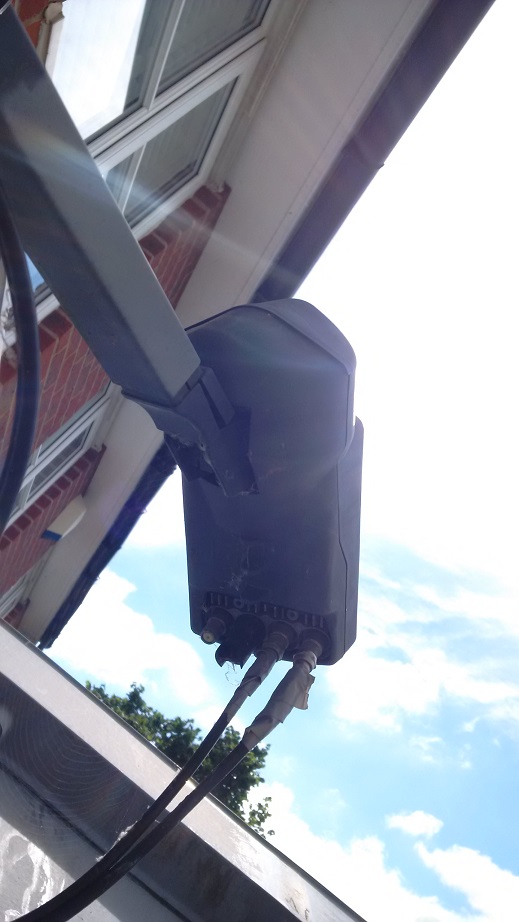

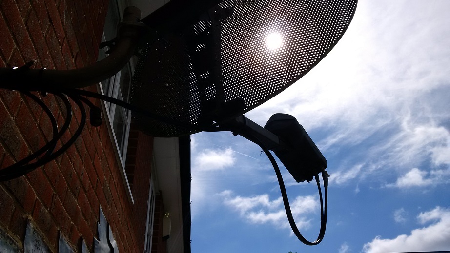

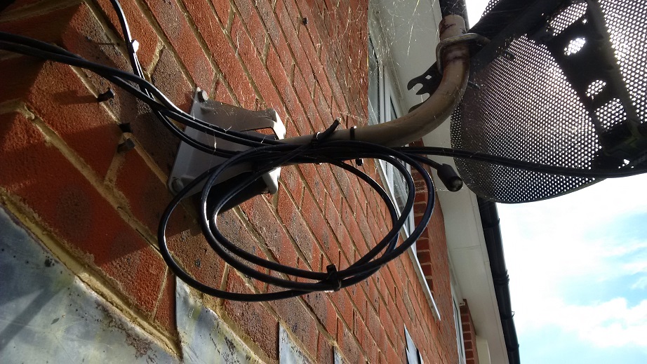

desmondCH Posted July 16, 2016 Author Posted July 16, 2016 The DVB-S2 tuner is a single card, with two satellite cables connected to it. I have attached photos of the dish itself - it looks like there is one disconnected cable, which I think used to feed another receiver elsewhere in the house (no longer anything beyond this computer connecting now) and the computer has two cables connected to it that run back to the dish. Dish appears to be fixed. Hope that helps? Quote
Griga Posted July 17, 2016 Posted July 17, 2016 Well, it looks like a Quad LNB (though not very professionally installed), not a Quattro LNB plus switch that may require DiSEqC. I guess that's why it works with NextPVR set to DiSEqC = None (on the same PC, I assume). In theory it should work with the same settings in DVBViewer. I have no idea why it doesn't. Sorry, no better news... Quote
