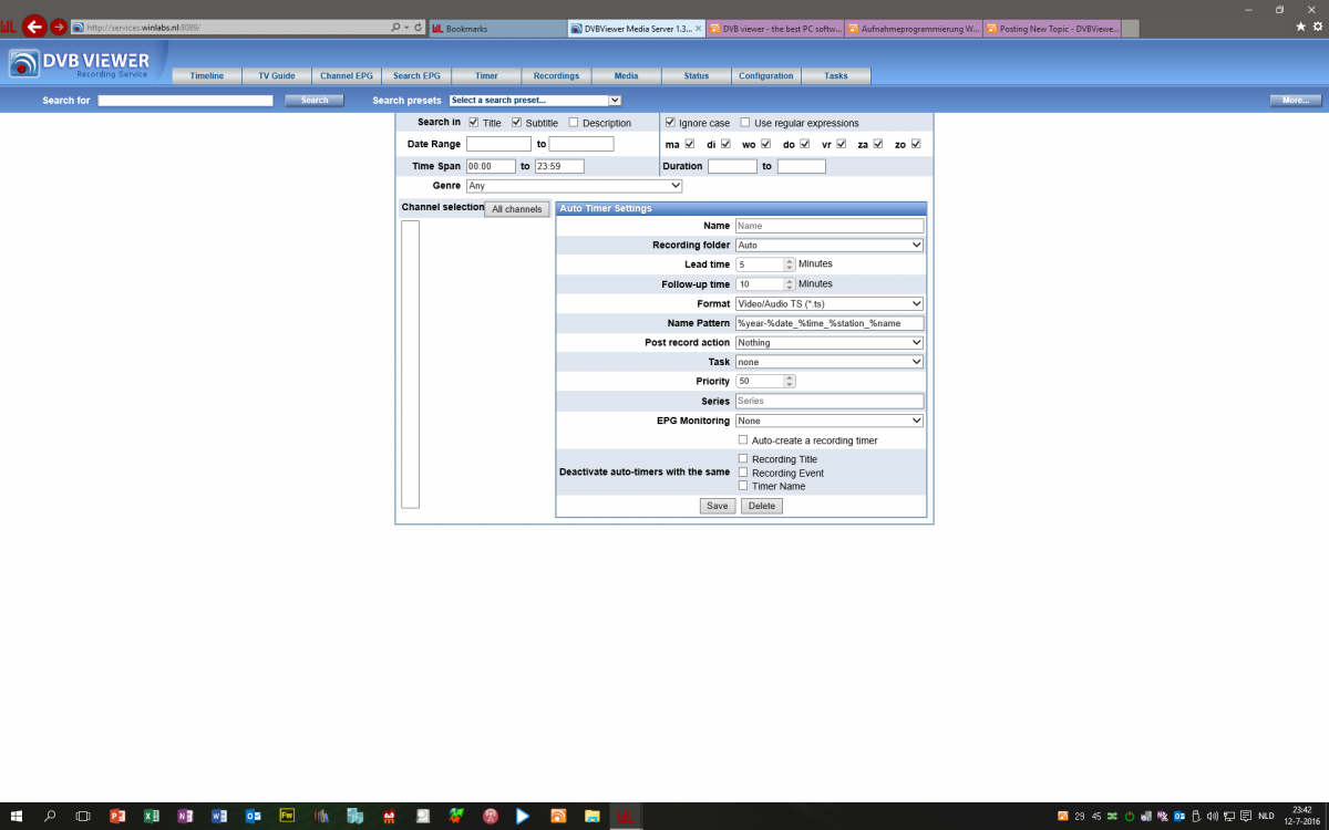

Today installed new version of recording service but have a problem when searching epg and channel selection which channel to search for but the list is empty.
Anybody has the same?
See attachment.

I use only favourites channels because i have so many so my choice was favourites only in webinterface and show radio channels and tv channels not selected but then it will not showup in the selection area.
Thanks for the hint after selecting TV channels it is available again.
