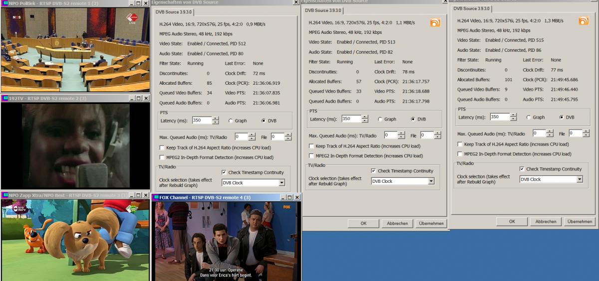

Open the svchardware.xml and add this line to the physical device with CI-module:
<entry name="MultiPID">1</entry>
Define as many RTSP devices in transedit as you think your CAM can open different channels simultaneously. (RTSP1, RTSP2..)
Then scan a corresponding transponder. Now you can preview more than 1 channel. The limit is the number of PIDs your CAM can handle ;)
With my Alphacrypt and a CanalDigitaal smartcard I can preview 4 programmes without discontinuities (didn't try 5 ;) ) . Though there are only 2 streams/programme = 8 PIDs

Hardware? How many programmes/PIDs? Without discontinuities?
TBS, two encrypted programs, PIDs don't know, discontinuities yes (in the first program when playback of the second program started, maybe due to the CAM)
