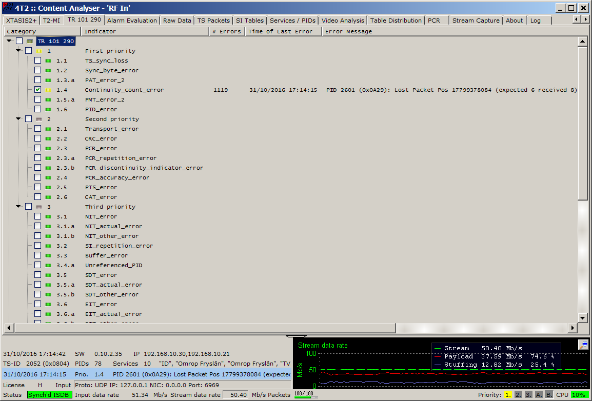

But I have nice tools that can deliver the stream. My (Dutch) cable reaches to 858MHz. Frequencies around 800MHz are used by LTE. Apparently the shielding of my cable is not sufficient. Luckily there are only less important channels but if you want watch them it's a pain in the neck. Here are some screen shots to show how the errors can belogged:
DVBSy T330 works with crazscan2. You can analyse a couple of modulation parameters incl BER. Via UDP/RST the mux can be steamded to an analyzer -> 4T2
From the powerfull TR 101 290 analyzer you only check "continuity_count_ error" in this case. After start you see the number of errors and the time stamp of the last.
Opening the log show all errors with time stamps (system time), PIDs etc.
continuity error.log

None of the Pictures you pasted seems to be from crazyscan2?

It's not about crazyscan2 but the 4T2 analyser. Maybe your DVB-C devices will lock. Or you have to find an application that can stream the mux. A streaming interface for Transedit has been asked, but no response from the dev..
