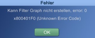

spAik Posted February 16, 2005 Posted February 16, 2005 hehe dont know what i have done wrong this time but the player always starts with the message that the graph couldnt be created ...i tried reregistering the DVBViewer filters but it doesnt work...also the other decoders dont want to work - the player makesa graph, but in this graph audio is missing :X
hackbart Posted February 16, 2005 Posted February 16, 2005 oh, i guess you started in the meantime an older version. Just execute the regfilters.exe Christian
spAik Posted February 16, 2005 Posted February 16, 2005 nope just installed it and switched a channel...i do a reboot now..perhaps then.,..
spAik Posted February 16, 2005 Posted February 16, 2005 souuuu, after changing everything i can, it still doesnt work...via graphedit i can see "audio callback" after the audio-decoders nothin more..ok, so good old v2

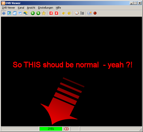

CryptMan Posted February 16, 2005 Posted February 16, 2005 (edited) Hi, 1. I got it to start under Windows 2000 (with another GDI+). 2. I do clean install of the latest v.3.0 - nothing works (DVBViewer starts, but can not closed, changin Language has no effect, etc.) - seems to be a problem with some XML Files (says the DVBViewer.log) - so i moved the XML's from the first 3.0 to the latest 3.0 - and it works. 3. The Network-Streaming to Windows 2000 Clienst still does NOT work - this point sucks realy [ Um nich zusagen - dat geht mir tierisch uff'n Sack *grml* ] MfG. Edited February 16, 2005 by CryptMan
hackbart Posted February 16, 2005 Posted February 16, 2005 The server/client just use windows api functions in order to request and receive data. I do not really think it is caused by a "the server does not like 2000" bug - since the functions are compatible downward to 95. @Concerning the problems with the setup.xml file. Stupid Microsoft! Try remove the setup.xml or use the attached one. Christian setup.xml
CryptMan Posted February 16, 2005 Posted February 16, 2005 I believe there IS an "don't like Windows 2000 SP4 - Something" in the CLIENT. If I connect the VLC Client to the Server it works (for the VLC Client) without any problems. I have tested this with more than 2 Windows 2000 SP4 machines (MPEG Decoder is InterVideo). Please take a closer look to the screenshot below (It is not manipulated) - the Windows 2000 client say >200% signal strength for the LAN Streaming Connection (It start by 100% - falls to <16% and then rises to >200%). Do you have tested the streaming with Windows 2000 ???
hackbart Posted February 16, 2005 Posted February 16, 2005 2x ack, this display counts the incoming packages vs. discontinuities. The calculation formula is probably not the best and the percentage value results by the fact that there is a wraparound (caused by non signed integer variables). Again it is more important to know what the server tells you about the packages send and the active connections. If there is something not working properly it is definitively caused by some network settings you made. Again I DID NOT USED SOMETHING ELSE THAN THE STUFF PROVIDED BY MICROSOFT!
Derrick Posted February 16, 2005 Posted February 16, 2005 I've already mentioned a couple of times that the client/server application sucks with a win2000 client as unicast device, though it does work with multicast.

Derrick Posted February 16, 2005 Posted February 16, 2005 ..yep, maybe I'll feel better with 20% win2k unicast: win2k multicast:
