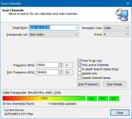

ShK Posted February 19, 2018 Posted February 19, 2018 I bought this Astrometa USB DVB-T/T2/C + FM + DAB/DAB+ (VID_15F4_PID_0131) cheaply from eBay and faced the same issue. I find out that the latest driver works on Win10x64, but you need to modify Astrometa driver's AMDVBT2BDA.inf -file: HKR,"Parameters",DVBCMode,0x10001,0 <----- DVB-T (default) HKR,"Parameters",DVBCMode,0x10001,1 <----- DVB-C Because driver is now modified you need to disable Win10 Driver Signature Verification. Otherwise it will give the error code, and does not work. Quote

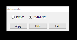

rvs Posted March 25, 2018 Posted March 25, 2018 (edited) I did a program a few years ago. You can find some information and links here. I do a new version here. Change : - Reset the device in an another thread - Can stay in systray - Target the .net framework 4.0, which is now the most common. Requires to start in Administrator because it read and write the registry and reset the device. It's provided as is. Only test in my PCs. Edited March 25, 2018 by rvs Add images 1 Quote
