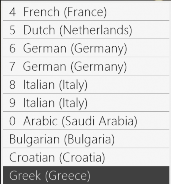

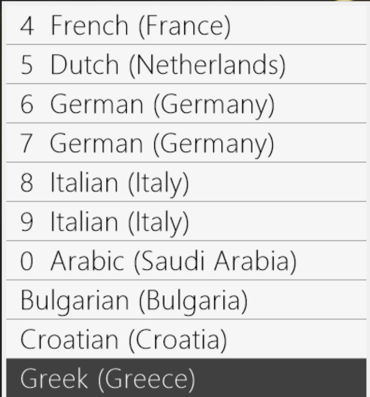

I apologize Griga, all movies I´m testing now show a maximum of 16 subtitle tracks, as per your test. My memory must have been playing games.
Only the numbering is weird, it goes like
1
2
9
0
blank
blank

1. "Only" 16 subtitle tracks are shown.
2. Numbering of the subtitle list is wrong, as per screenshot above.
3. No chapters available.
