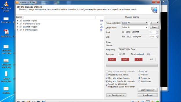

Mohammed Yasir Posted August 26, 2017 Posted August 26, 2017 Hi, I recently purchased DVBViewer from you but I had to wait about 20 days for my hardware to arrive. Now that my hardware has arrived i cannot search the channel through my cable tv connection. Really need your help in this regards. 1. These are the channels that i receive from my cable connection http://abohomanbangla.com/Bangladesh_web_directory/Bangladesh_tv_frequencies.html 2. I have no idea what to do. This is the screen i get but i don't know what to do (Attached) Quote

Griga Posted August 26, 2017 Posted August 26, 2017 Click the "Scan Range" button (see first screenshot). This will scan all 588 frequencies (parameter combinations) in the Cable All list, which takes quite some time. Usually it's better to use a transponder list (= frequency list) that contains exactly the frequencies of your cable provider. Please read more about it in the Wiki. Quote

Mohammed Yasir Posted August 26, 2017 Author Posted August 26, 2017 15 minutes ago, Griga said: Click the "Scan Range" button (see first screenshot). This will scan all 588 frequencies (parameter combinations) in the Cable All list, which takes quite some time. Usually it's better to use a transponder list (= frequency list) that contains exactly the frequencies of your cable provider. Please read more about it in the Wiki. I did that nothing happened Thanks Quote

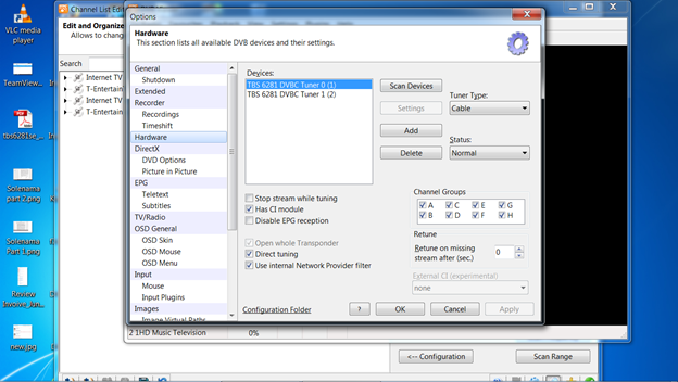

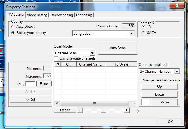

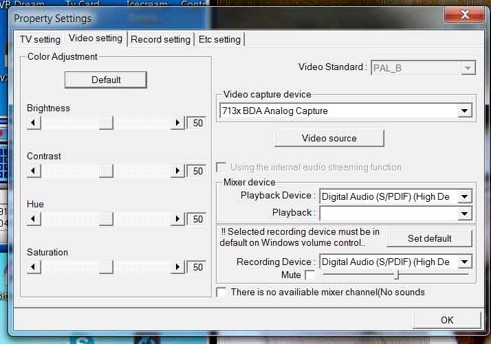

Mohammed Yasir Posted August 26, 2017 Author Posted August 26, 2017 6 minutes ago, Tjod said: Instead of a device, you can look up the reception type and parameter from the TV which is working or ask you cable TV provider what exactly they use. I am receiving all the channel with the other device connected. but that device is not detected by the DVBViewer that why i had to buy that tbs pcie tv tuner card. How ever here is the screen shot of that device configuration. Quote
Mohammed Yasir Posted August 26, 2017 Author Posted August 26, 2017 On the 2nd image when i switch it to cable tv that is CATV i get all the desired channels that is being provided by my cable guy Quote
Derrick Posted August 26, 2017 Posted August 26, 2017 Analogue devices are not supported by DVBViewer. Quote
