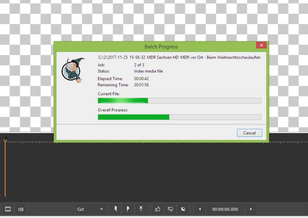

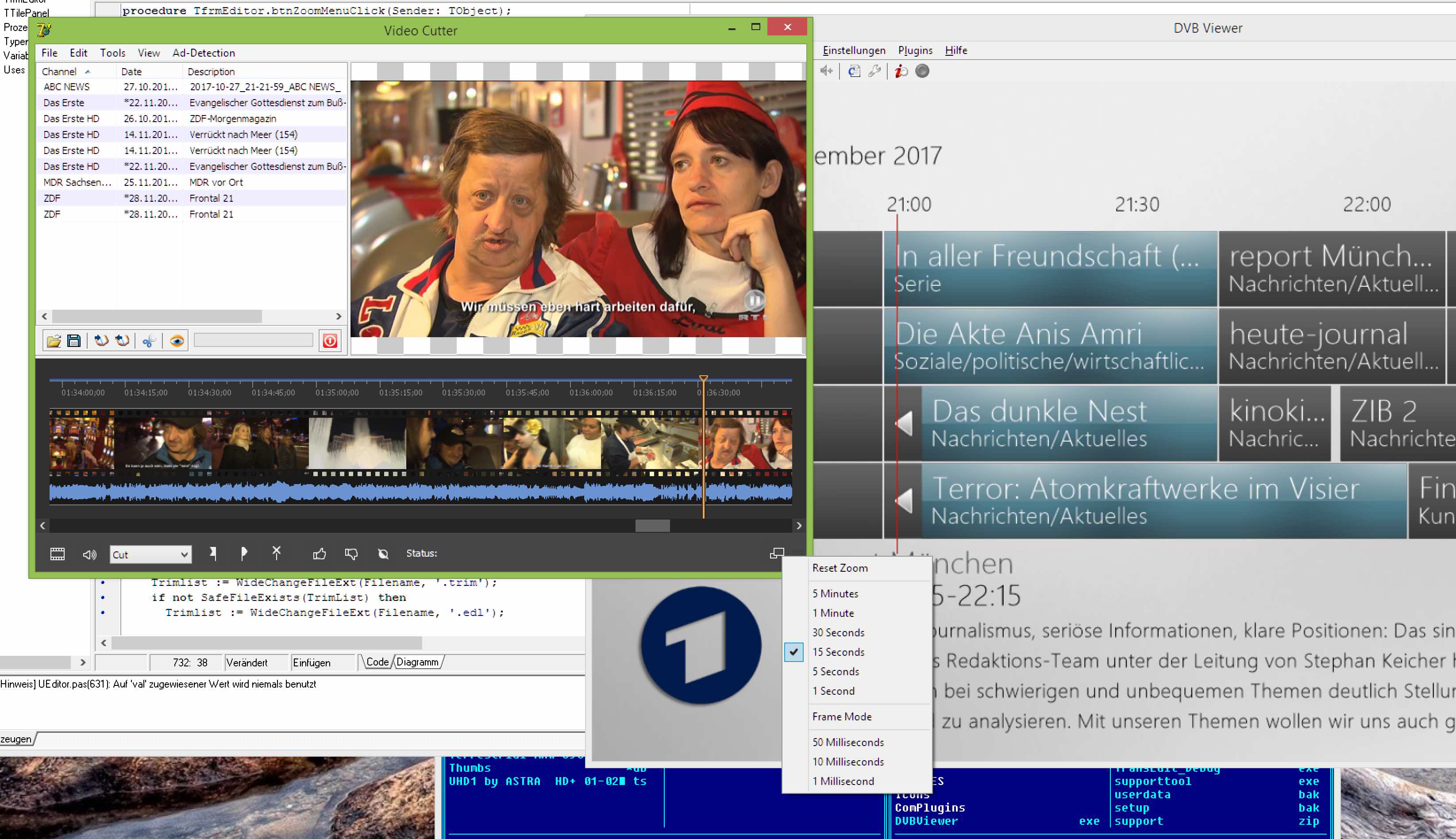

I plan to publish a complete editor for recordings in the first half of 2018. It currently works fine with Mpeg2, H264, HEVC and all kind of audio formats.
There are still a few issues and the look and feel will differ compared to this screenshot. The idea is to have the recording database on the left, the editor-preview on the right and the slider bar and buttons to trim below.

hackbart
I assume you mean something like this :)
Yes this is already part of the system. I think it does not make sense if you can not select the frame you will cut. As i said the solution is already quite complete, but the main "problem" i have is to draw a thin line between keep it simple and keep it complete. I'd love to implement the complete editor inside the DVBViewer and after today i'm unsure if it makes sense. I started adding a main menu with the basic functions i really like to have and the ability to configure com skip as easy as possible.  I'm now at the point where i rethink. I probably will offer a separate application for editor only. The next point is, do i offer a terminal/console application which does the automated stuff, or do i add a com server to the application.
I probably will create a stand alone version first and think of the additional steps later. I know this is complaining at a very high level ;) Did i mentioned that HEVC recordings also run as well, as H264 and Mpeg2.
Christian

hackbart
Hi you all,
i just want to inform, that the project is nearly completed. It still needs some internal beta tests, but you can expect a solution which helps you editing your videos with an easy to use editor and allows you to get rid of commercials automatically. You will also be able to use batch automation with a command line tool.
It will support all video/audio formats used in DVB. Which means in detail MPEG-2, H.264, HEVC (H.265), AAC, AC3. All audio-, teletext- and subtitle-tracks will be kept untouched, so you don't have to worry about them.
