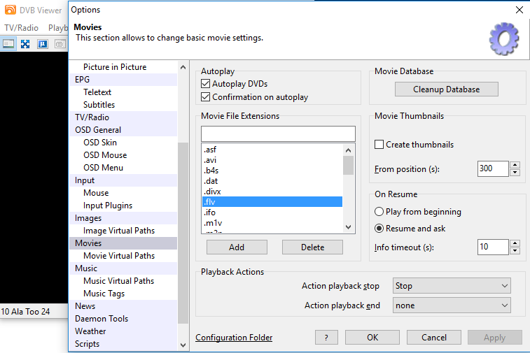

Check out Options->Movies and add the .flv extension and see if you could make it run.
Thanks.
I add .flv extension.
But, But it's still not open.

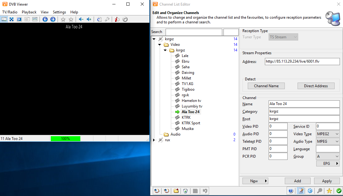

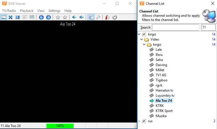

But the same list; It was attached to the channel list.
Why does not it open on the channel list?

Because the channel list only supports DVB compliant streaming formats that contain a transport stream or an AAC/MP3 audio stream (e.g. internet radio). Read more about it here in the "Streaming" section. .flv is Flash, which is no DVB compliant format.

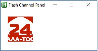

- Download the Autohotkey Installer
- and install Autohotkey 32-bit Unicode
- Download the FlashChannelPanel.zip
- Unzip it to a FlashChannelPanel folder
- Start script by doubleclick the FlashChannelPanel.ahk
- Single Leftclick on the Ala-Too 24 icon starts the channel in an already running DVBViewer Pro client. If DVBViewer is closed the Ala-Too 24 icon click wont have any effect.
So now you have a flash channel panel that you could add more channel icons into (with some more coding) if you have more of these .flv channels
