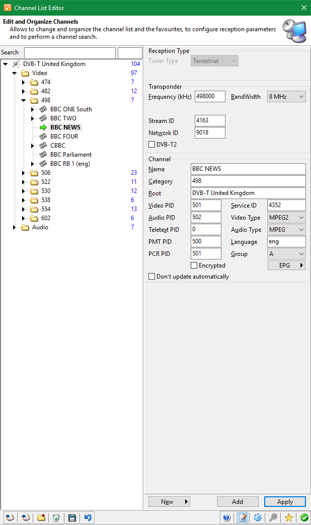

Try*3 Posted February 13, 2018 Posted February 13, 2018 The teletext entry in the main menu [or by right-clicking in the main window] is greyed out, inoperative. I am in the UK. I am tuned to BBC News. All BBC channels carry teletext [News, weather, ...]. I have updated to v6.0.4. The same problem was seen in earlier versions. I have tried on 3 computers to make sure it is not my own computer causing this. I have tried 3 TV tuners to make sure it is not a hardware problem - All my tuners are tuned in to digital channels only [I don't think we have analogue channels left here anymore] - My newest tuner is Hauppauge WinTV DualHD which explicitly states that it can handle teletext - My older tuners could show teletext when used with Windows 7 Windows media centre but I am now on Windows 10 so that option does not exist. They could also show teletext using their own proprietary software [TerraTec, KWorld] in Windows 7. I found a 2011 thread that indicated it was an issue that would be addressed in future versions. Teletext Button Non Functional The wiki page on teletext mentioned 'Teletext PID' so I checked this. My channels show 0 in that box [diagram attached in case it holds useful info]. I tried, without any understanding of what I was doing, entering the same number as the Video PID but there was no change. How can I get teletext to work? Denis Quote
Griga Posted February 13, 2018 Posted February 13, 2018 3 hours ago, Try*3 said: The teletext entry in the main menu [or by right-clicking in the main window] is greyed out, inoperative. Here teletext is enabled in DVBViewer when I receive the Freesat versions of BBC News (HD and SD). Both provide teletext subtitles on page 888. There are no other teletext pages. I guess the Freeview version doesn't provide old-school teletext anymore, but limits itself to DVB subtitles. If there was teletext, DVBViewer would detect it automatically and add the teletext PID (Packet Identifier) to the channel data. However, if you are expecting advanced MHEG5 text information by means of the corresponding DVBViewer add-on... well. that's a different thing that I wouldn't call teletext. Quote

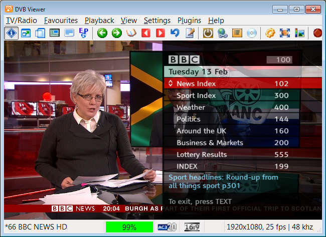

Try*3 Posted February 13, 2018 Author Posted February 13, 2018 Thanks for replying but - I can see DVB BBC teletext on my tellie on Freeview [news. weather, ...]. There are hundreds if not thousands of pages. It does not limit itself to subtitles. Sample attached. - As I mentioned above - Windows media centre software, TerraTec & KWorld software [and, apparently, Hauppauge software] can display teletext without any problems but DVBViewer does not, not even on the same channels & the same hardware that the others coped with. So, there is a teletext signal but DVBViewer is not detecting it for some reason / not setting the channel's teletext PID for some reason. I do not know what you mean by "advanced MHEG5 text information" or the "corresponding DVBViewer add-on". Quote

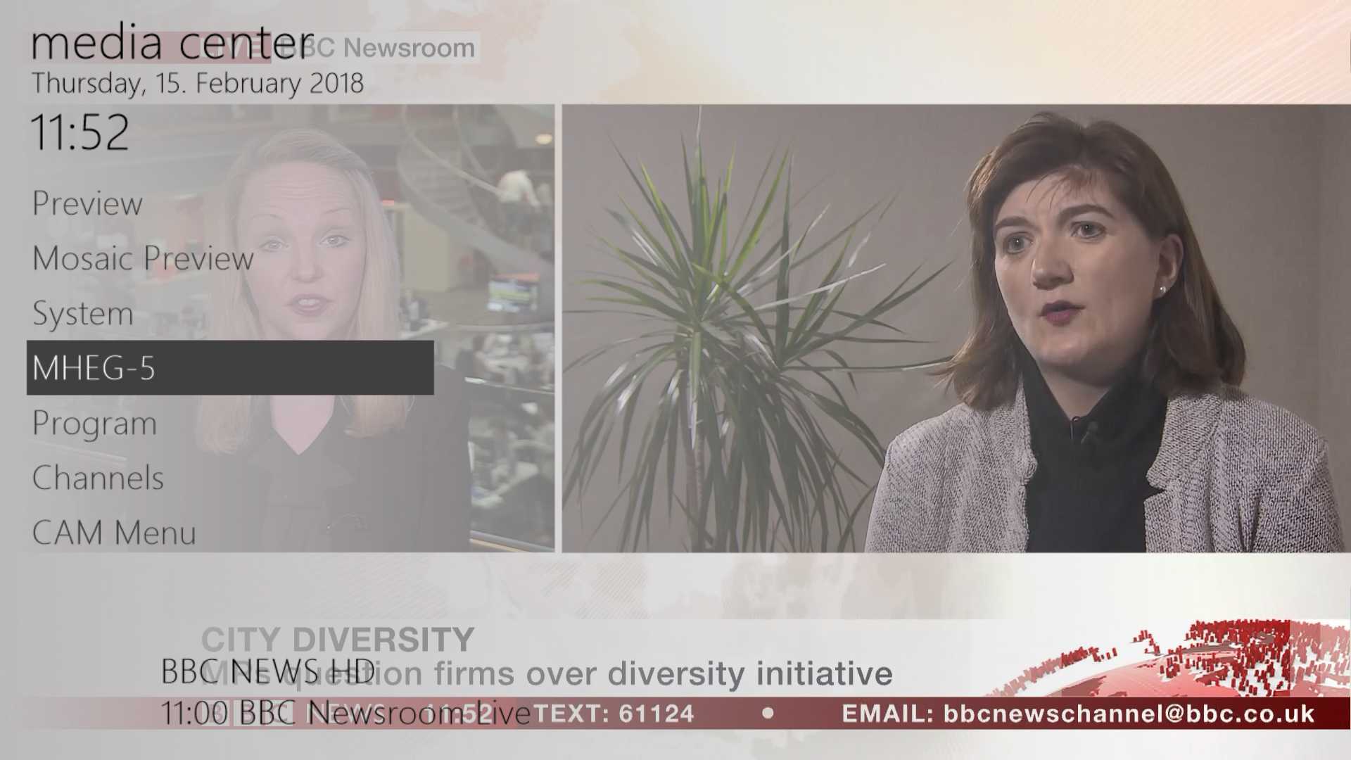

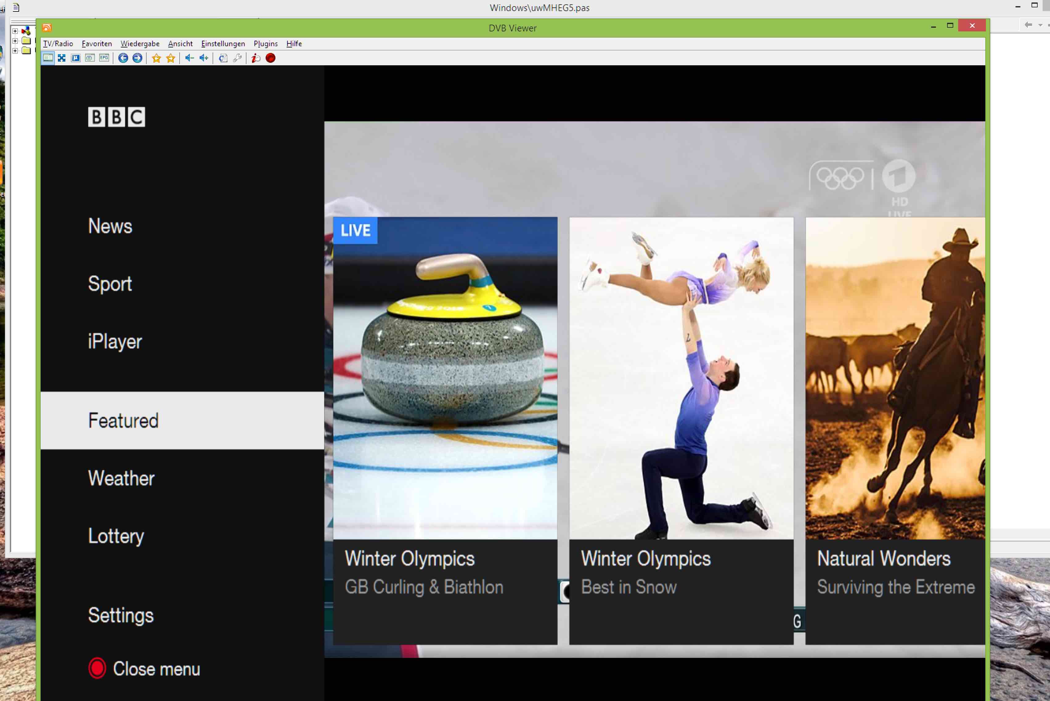

Griga Posted February 13, 2018 Posted February 13, 2018 I see... that is what you mean : I can receive it here in Germany via Freesat with a Hauppauge card (!) and the MHEG5 add-on (see here). Or just select Help -> Order / Unlock Add-Ons in DVBViewer. However, there is a restriction, if I remember it correctly. The add-on is not able to play BBC videos or something like that... sorry, I'm not really familiar with the UK TV stuff. 2 hours ago, Try*3 said: They added the comment that no USB TV tuners have MHEG5 capability. I Rubbish! MHEG5 is a software thing, not hardware dependent. Most likely the Hauppauge support people confused it with the fact that the Hauppauge software is not able to handle it. I can receive it here as well with a DVBSky S960 USB box. Quote

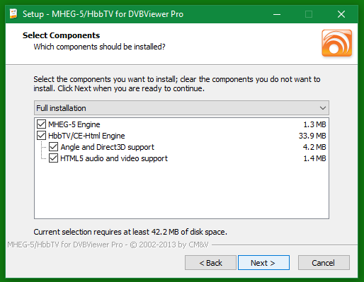

Try*3 Posted February 15, 2018 Author Posted February 15, 2018 I bought the addon, installed it, read its ReadMe, started the DVBViewer application. I tuned in to BBCNews because that has digital teletext [mheg5] as shown in our posted pictures above. When I press F5 to get digital teletext [mheg5], an error message appears. I was not expecting it to try to use the internet at all because digital teletext [mheg5] is transmitted data but I did happen to be connected to the internet at the time so I disconnected & tried again with the same result. Quote

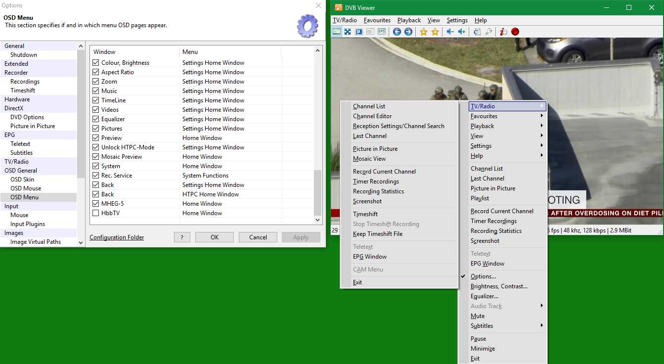

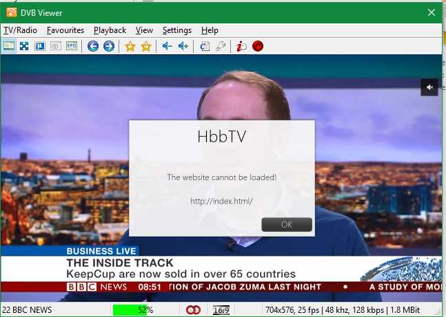

hackbart Posted February 15, 2018 Posted February 15, 2018 Oh, interesting. This actually happens if they also sent AIT informations. Can you provide the support.zip after you started the DVBViewer in Debug mode? In this case the log will contain more information. You might also check the following: Open the Tweaker Tool and check the "Disable HbbTV" option. In this case these false informations won't be used instead of Mheg5. Quote

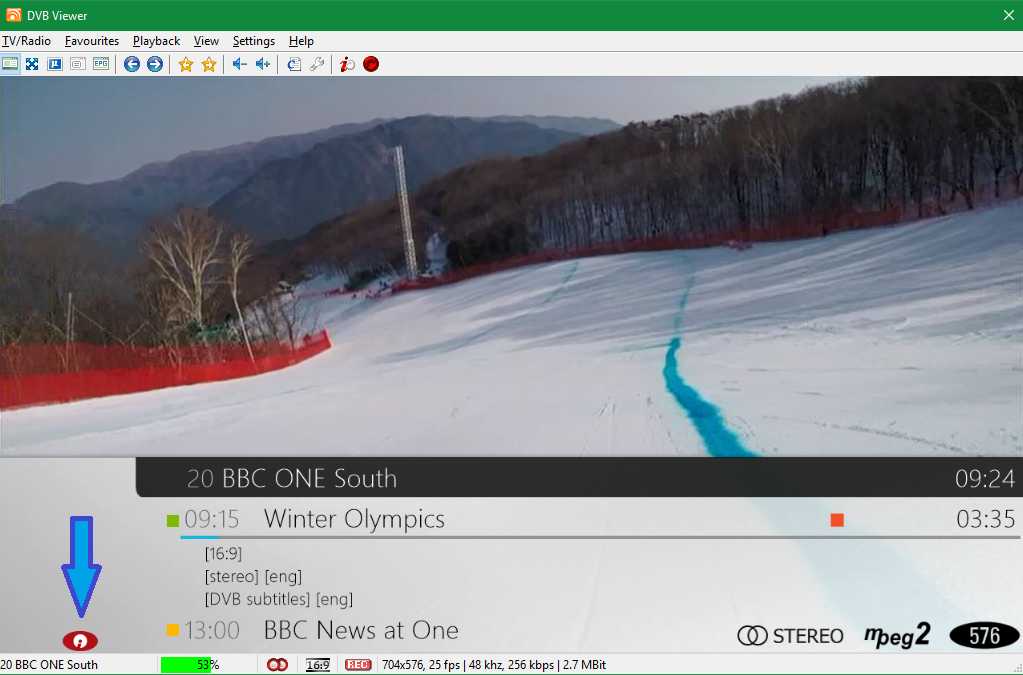

Try*3 Posted February 15, 2018 Author Posted February 15, 2018 When it warned me that the addon would be installed in an existing DVBViewer folder, I let it proceed as that seemed logical. Nothing about mheg5 is shown in any OSD but I do see what I believe to be the mheg5 symbol onscreen for a moment when changing channels to one that transmits digital teletext [mheg5]. Picture attached - the one showing snow. The symbol only appears for BBC channels and not for those that have no digital teletext, which makes sense. I also tried retuning all channels. I also went back to the Help, Order/Unlock, hbbtv/mheg5 entry to check that my new key had been saved & that the checksum shown was correct. I found the entry in Options, OSD menu for mheg5 and hbbtv and I cleared the checkbox for hbbtv [but left mheg5 entry checked]. After restarting DVBViewer, - nothing now happens when I press the F5 key - mheg5 is still not shown in any OSD [picture attached - the one showing both the Options, OSD setting and how the OSD appears] I used debug mode twice and tried the F5 key for a couple of BBC channels then generated support.zip [attached]. I do not understand why there are entries for bbc internet addresses as mheg5 does not require an internet connection. I have just had a popup in this thread to tell me that you have sent two replies while I have been typing this so I'll end this & read them. support.zip Quote
Try*3 Posted February 15, 2018 Author Posted February 15, 2018 I just used the Tweaker to disable hbbtv. I restarted DVBVwr but there has been no change [possibly because I had already unset hbbtv in Options, OSD menu]. I hope the support.zip file [in my last post] explains the situation. Denis Quote
Try*3 Posted February 15, 2018 Author Posted February 15, 2018 (edited) Will it provide useful information if I uninstall DVBViewer and the Add-in then reinstall both? - I will await your response before uninstalling, reinstalling in case doing so would not be helpful at this stage. - It seems to me that the cleanest state I could achieve would be installation of DVBViewer, full tuning without any subsequent TV station deletions etc, installation of the addin, disable hbbtv. [followed by a test on a BBC channel, a test using debug mode, creation of a new support.zip] I notice that an MS Visual C++ module installed this morning and I assume that makes sense to you [I have not done anything else that might account for its appearance today]. Denis Edited February 15, 2018 by Try*3 Quote
Griga Posted February 15, 2018 Posted February 15, 2018 Activating the text service requires the famous "Red Button" , which (as term) appears in every second sentence about British TV The default OSD keyboard mapping in DVBViewer is red: F5 green: F6 yellow: F7 blue: F8 Additionally the arrow keys and the return key are used for OSD navigation. The keyboard mapping can be viewed/changed on Options -> Input. Quote
Griga Posted February 15, 2018 Posted February 15, 2018 1 hour ago, Try*3 said: nothing now happens when I press the F5 key Sorry, I didn't spot that. Quite a lot of text here... Quote
Try*3 Posted February 15, 2018 Author Posted February 15, 2018 (edited) "red: F5" - Yes, I have been using the F5 key. No red button has been appearing onscreen at all, just the little red symbol illustrated in my previous post and it disappears within about half a second [the "Red button" on my TV normally appears after about 10 secs and stays onscreen for about 30 secs]. I have also discovered that pressing my mouse wheel acts as the middle-key and brings up the relevant OSD which shows an entry for MHEG5 but neither clicking on it nor pressing Return while it is selected have any effect [I played around choosing the System & Mosaic entries just to make sure that the OSD itself was working as expected]. I had previously thought that "OSD" meant the menu tree that appears when I right-click on the screen which is why I posted a screenshot of those menus before. Edited February 15, 2018 by Try*3 Quote
hackbart Posted February 15, 2018 Posted February 15, 2018 Did you entered your mheg5 credentials in the key tool? By the way there is indeed a problem inside the DVBViewer. I did not knew that BBC does deliver also HbbTV content: I should filter the given URI's if they are not correct. Quote

hackbart Posted February 15, 2018 Posted February 15, 2018 Yes, you might check the following (this does not solve your mheg5 problem): Enable HbbTV in the Tweaker, create the following VBS-Script in notepad and execute it, when the DVBViewer is running: Dim DVBViewer Set DVBViewer = GetObject(, "DVBViewerServer.DVBViewer") DVBViewer.HbbTV.LoadInBrowser "https://www.live.bbctvapps.co.uk/tap/home?#&*history=broadcast", 1 DVBViewer.HbbTV.Visible = 1 It opens the BBC HbbTV Website in the DVBViewer. So far everything runs fine, but i stumbled over the Geocheck when it comes to the HLS streams. Quote
Try*3 Posted February 15, 2018 Author Posted February 15, 2018 Thanks, the hbbtv.vbs works [as long as hbbtv is not disabled in the Tweaker]. I think I should go ahead and reinstall. Denis Quote
Try*3 Posted February 15, 2018 Author Posted February 15, 2018 Success. Reinstalled the add-on and teletext [mheg5] now works. - It only works on BBC's SD channels not HD ones [this might be correct behaviour for all I know. My HD set-top box does not have any teletext facility & my TV itself is SD so I have nothing HD to compare the behaviour to]. It is not really a problem in any case because it only takes a moment to change to one of their SD channels. - I have to keep hbbtv disabled but that is not a problem [as long as this simple teletext service continues, I will use it. If they ever stop the service and move to hbbtv-only then I would probably choose to use my browser and go to their website anyway]. Thank you both for your help. I realised that I had had an installation problem with the add-on as soon as I started the reinstallation - I saw the attached dialog and I had definitely not seen that during the initial installation. So I must have left Outlook 2007 or Windows defender running the first time and one of them had corrupted the installation. - - - - - - - - My initial question was prompted by the teletext entry being greyed out. Whilst I now appreciate that I should have realised that "teletext" was being used in its international sense & that I should have been asking about mheg5 interactive digital services, we all just say "teletext" here when referring to it. In the next day or so I will raise a new forum thread - called something like How to get "Teletext", "Digital teletext", "Digital interactive services", "MHEG5 interactive services" in the UK, RoI, NZ, ... [teletext menu item greyed out] so that I catch all the search terms people might try. - I'll explain that the menu item "teletext" refers to foreign teletext services and that we need to buy the add-on. - I will explain what the difference is in the very broadest of terms and will mention hbbtv services as well. - I will mention that there is further scope for confusion because some people seem to refer to teletext as being the method by which DVB-T provides subtitles. - I'll explain the Help, Order/Unlock route for finding the add-on and ordering it. - I'll explain how to use the keyboard F5, F6, F7, F8 keys and how to navigate around without a remote. - I will include disabling hbbtv but I will note that this might be a quirk of my own computer / keyboard rather than a limitation that necessarily applies to everybody. I will also be amending my Amazon.co.uk review of the Hauppauge WinTV DualHD {my username there is Londain} to tell people that it is possible to get "teletext" {it is a UK & Republic of Ireland audience} by buying DVBViewer & the MHEG5 add-on. I'll leave this until after I have written the explanatory thread in this forum so that I can tell Amazon customers to see that thread for details. Denis Quote
Griga Posted February 15, 2018 Posted February 15, 2018 13 minutes ago, Try*3 said: Whilst I now appreciate that I should have realised that "teletext" was being used in its international sense & that I should have been asking about mheg5 interactive digital services, we all just say "teletext" here when referring to it. Thanks for clarification. That's something to keep in mind... Maybe we can provide a test version if Christian finds fixes concerning this matter and if you are interested. I will post here when such a modification is ready. The availability of HbbTV and MHEG5 is new for us. Quote
hackbart Posted February 15, 2018 Posted February 15, 2018 Yes, there is a small fix i made which ignores non existing links inside the AIT. AIT is some table with urls which are used to load the HbbTV content from a server. According to your screenshot and .log you have links to index.html without any url in combination. I assume because the streams do have some basic html content sent via dvb. I now ignore these kind of links and allow only regular URLs. HbbTV and Mheg5 should run parallel without any problems. If both are available HbbTV will be preferred. At least in theory, because i never saw such a hybrid till today. Can you also try to play some iPlayer streams? Do they work? If not maybe you can start the DVBViewer in debug mode again and provide us the log file, after selecting a video. Quote
Try*3 Posted February 15, 2018 Author Posted February 15, 2018 Yes, I will always be willing to test anything for DVBViewer. Griga - I can see from that picture you posted earlier today that you are getting "mheg5 interactive digital text services"** on BBC News HD whilst I cannot only get them on BBC News {SD}. - I will experiment with one of my old computers to see how they behave just in case it is a quirk of my current one. - You use FreeSat & I know that it does not use exactly the same combination of technical standards so it might be something to do with that [possibly]. - ** That's why we just keep saying "teletext". HackBart - Yes, I'll find something to play in BBC iPlayer and let you know how I get on. If there are any problems, I'll include debug mode and post a support.zip. Denis Quote

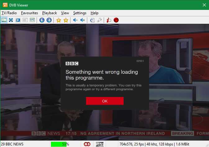

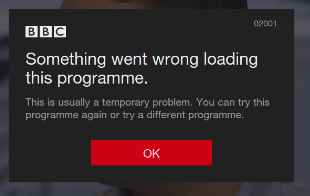

Try*3 Posted February 15, 2018 Author Posted February 15, 2018 I opened hbbtv using the vbs file you gave me and selected some of the news clips but each one failed after a few seconds of a spinning wheel then displayed the [attached] dialog . Because of my experiences earlier today, I used the Tweaker to disable MHEG5 in case it would help. I tried again with the same result & the same error dialog. Support.zip attached I will try again later this evening in case the BBC really did have a temporary problem from about 17:00 to about 17:20 during my tests. I will post again if there is any difference. 20180215 171949 support.zip Quote

hackbart Posted February 15, 2018 Posted February 15, 2018 ah okay, i see that i'm blocked here at a certain point. You got a few more requests and you also get a error message. Quote
Try*3 Posted February 15, 2018 Author Posted February 15, 2018 (edited) 14 minutes ago, hackbart said: ah okay, i see that i'm blocked here at a certain point. You got a few more requests and you also get a error message. That last [non-deleted] post of mine above yours with the diagram of a BBC error message is my response to your request to try BBC iPlayer [i.e. to play clips from BBC hbbtv]. support.zip attached just below that diagram. Edited February 15, 2018 by Try*3 Quote
Try*3 Posted February 16, 2018 Author Posted February 16, 2018 I just tried the BBC hbbtv again with the same results, trying to play a news clip yielded the attached error dialog. Support.zip attached. I then opened my browser, went to their website and played one of the failing clips successfully. 20180216 125206 support.zip Quote
Griga Posted February 16, 2018 Posted February 16, 2018 Thanks for testing. Christian is looking after it (and found a way around geo-blocking), but it seems that there is some content protection so that it can't be loaded / viewed without sending a certificate to the server. I doubt that we will get it from the BBC Quote
