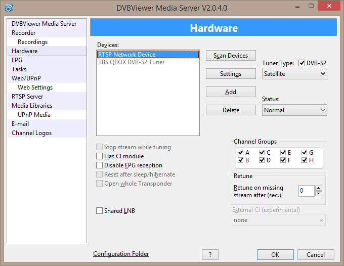

Here is a screen shot of the hardware settings.  The TBS QBOX is set to "Do not use.
Is this correct or is there something else that I have inadvertently not set up?

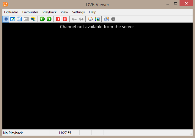

I am still getting the error :
As you can see I am getting No Playback at the bottom of the screen.  Is this relevant to this problem?

The DMS uses the RTSP Network Device for TV/Radio reception. This device is configured for connecting to a Sat>IP server at address 192.168.1.2. I'm still waiting for a reply to
19 hours ago, Griga said:
Which server is it?
or with other words, what is your expected TV source?
Anyway, this connection doesn't work, as your svcdebug.log (created by the DMS!) reveales:
Quote
TRTSPNetworkStream   OpenDevice       Server not found: rtsp://192.168.1.2:554/
The failure chain: DVBViewer as DMS client can't receive TV because the DMS can't receive TV because its RTSP Network Device doesn't work because it can't connect to the (still mysterious) server for which it is configured.
 I have removed the RTSP Network Device from the DMS Hardware and this cures the problem!!!!!!
