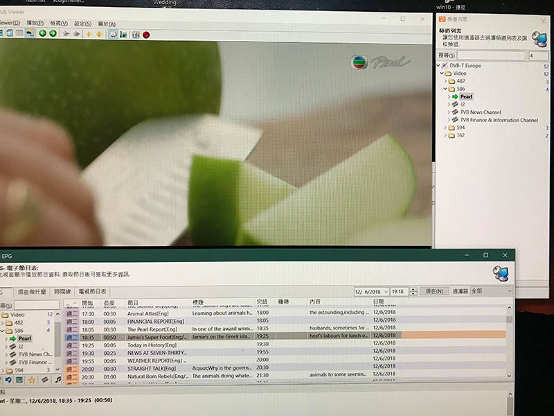

I just did a  test:
  I installed v5.6.4, not working though, so I reinstalled the v6.1.1 back and restart DVBViewer debug mode, this time is worked, EPG , channel list both OK, please see the attached support.zip file.
However after closing, reopening, restart PC then it is not working again. This problem seems happened randomly.
