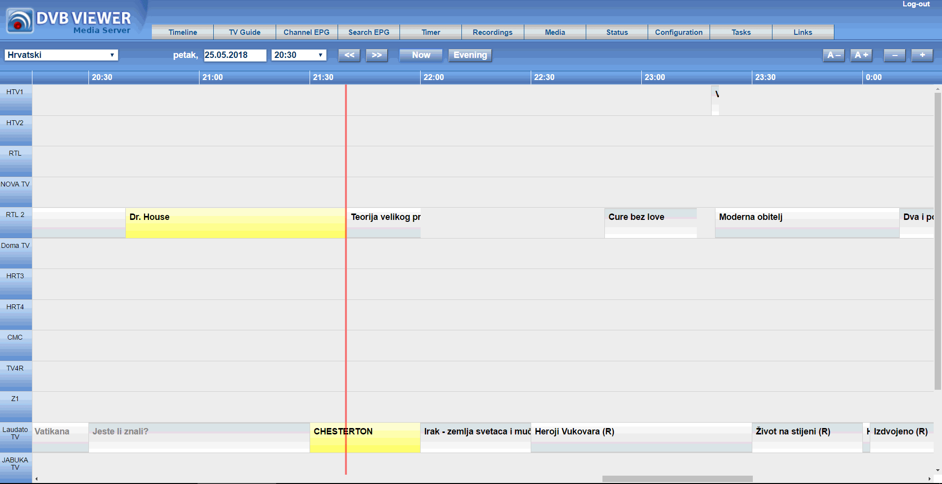

Well, I'm not sure what exactly is a problem, but sometimes (more often then not), there's no EPG information. I'm viewing it with Media Server, as it is the easiest way to program DVBViewer to record.
I'm in Croatia and there might be some EPG compatibility going on, but my TV (old Panasonic plasma set) sees EPG, but not DVBViewer.
Is there a way how I can let you see what's going on with EPG data and why sometimes I don't see all EPG information? It looks like there's some shows, but many aren't recognized (with TV, there's all EPG info).
I try manually start EPG task, but it doesn't give results. Also, I prolonged time to 60 seconds, then even more (160s), it didn't helped.
EDIT: I attached image how it looks like, sometimes there's more shows, sometimes it looks like this, very "deserted". As I said, TV set has it all populated, so I guess there's EPG data, but for some reason DVBViewer doesn't see it, or something.

Issues like this can be caused by broadcasters that frequently (daily) change the EPG Event IDs assigned to programmes, or even worse, assign the same Event ID to different programmes over time. This causes problems if already present EPG data interferes with newly received data.
The Event IDs (as defined by the DVB specifications) are numbers that are supposed to serve as programme identification label and to remain the same over time so that programmes can be recognized even if the title or the scheduled time change. Since DVBViewer saves EPG data permanently in a database, it must rely on the Event ID mechanism. If it is not handled properly by the broadcaster, the whole EPG handling may get disturbed heavily.

I would try the "Clear the EPG list before an EPG update" tweak, that automatically deletes old EPG data before an update starts:
  1. Stop the DMS
  2. Launch DMSTweaker.bat (see installation directory where DVBViewer.exe is).
  3. Find the corresponding checkbox, tick it and save.
  4. Start the DMS and perform an EPG update in the Web Interface. After that all EPG data should be present.
The tweak can help to avoid most of the issues caused by the broadcaster behaviour, but not all, because the DMS also updates EPG data when it receives a channel. A daily automatic EPG update (including deletion of the previous data) is recommendable.

Thanks, I think you explained exactly what's going on here in Croatia and why I can't see complete EPG information, but just partial and sometimes very sparse.
I now set suggested tweak and again I have full EPG information (yesterday I had it, but today again I was back to sparse EPG till I saw your explanation and set tweak as suggested).
