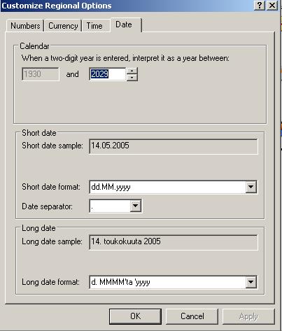

kookoo Posted January 14, 2005 Author Posted January 14, 2005 (edited) dd.MM.yyyy And what happens with DD.MM.YYYY Are there some entrys, if you use the attached Setup.ini?? DD.MM.YYYY is not an option. Attached a screenshot from my date settings. No timers appear with the setup.ini you provided. And when I shutdown DVBViewer the entrys you added are gone. Could a reinstall help? Thank you for your help and time! Edited January 14, 2005 by kookoo Quote

kookoo Posted January 14, 2005 Author Posted January 14, 2005 Ok, no it seems to work! The problem was....uhm, this is maybe little embarressing but my system date was set to May 2005. Thank you guys for trying to help me out. Sorry for wasting your valuable time and I try to double check everything next time Quote
