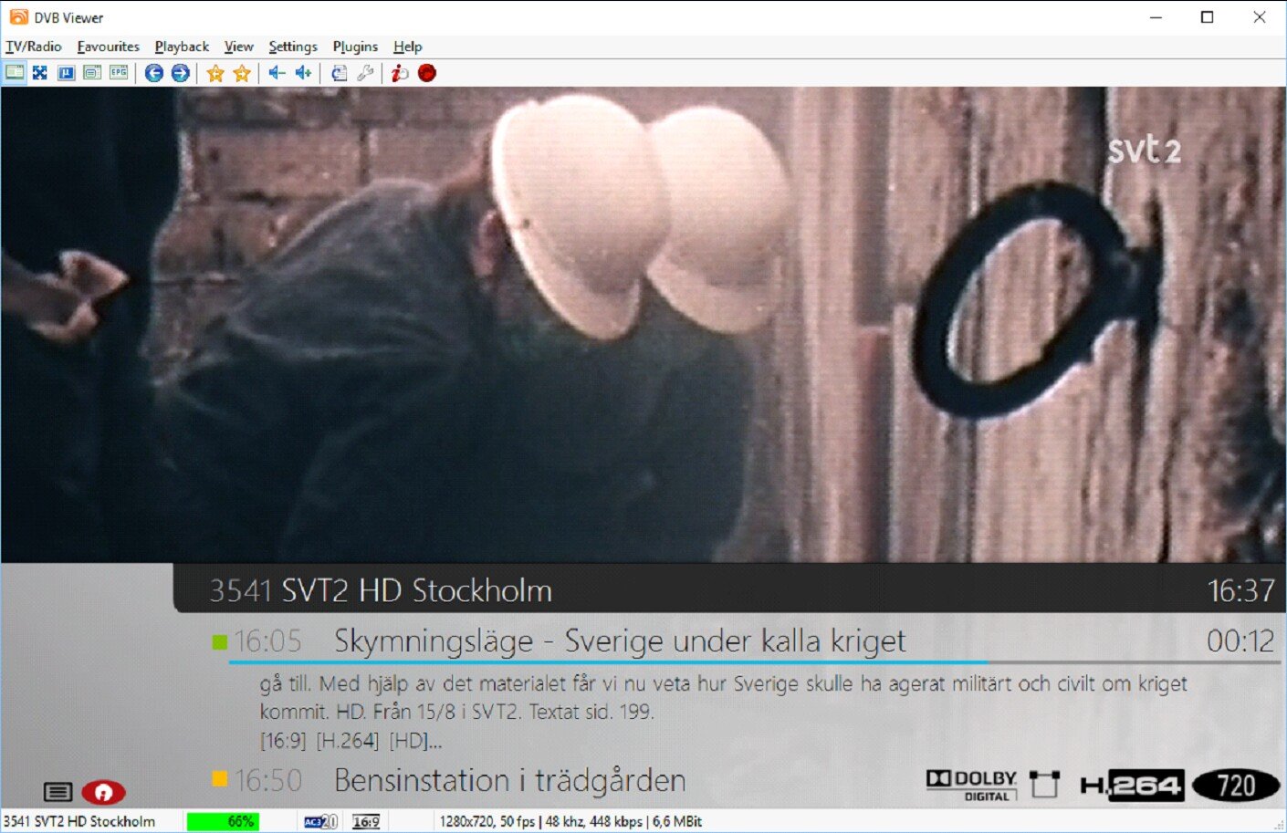

If I tune into Rai News 24 @Astra 11288V I get the "red indication" that there is a HbbTV content.
But when I enable HbbTV there is no HbbTV. Same thing with SRF Info @ HB 13E. Several other channels are OK with HbbTV.
This channel (SRF Info) worked previously with HbbTV. I don't know if the terrestrial channel SvT broadcast HbbTV or not. But I get the same indication on this channel.
See picture:

19.08.18 19:11:13.031 Hbbtv.StartTV        IsTV: 1 Name: SVT1 HD Stockholm
19.08.18 19:11:14.530 Hbbtv.StartTV        IsTV: 1 Name: SVT1 HD Stockholm
19.08.18 19:11:17.092 TDVBSourceRenderer   RealignWindow (VP) (0,0,1126,633)
19.08.18 19:11:17.308 TAITParser           SVT User Agent check http://hbbtv.play.svt.se/device_infos/index.xhtml (2)
19.08.18 19:11:17.740 TAITParser           SVT User Agent check http://hbbtv.play.svt.se/device_infos/index.xhtml (2)
19.08.18 19:11:17.741 Hbbtv.LoadInBrowser  Set transparent Colorkey

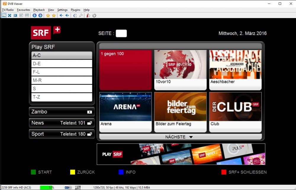

But I do know that SRF info had HbbTV content, which worked fine:
