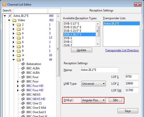

In the DVBViewer Channel Editor the Reception Settings (-> click gear wheel icon) should look like this:
Additionally the "Site" data must be configured correctly. Please check it.

it is one of the standard channel lists shipped with DVBViewer (available for Astra 19/23/28° E and Hotbird 13° E). Go to Reception Settings -> select DVB-S in the list of available reception types -> select the transponder list -> set up DiSEqC -> click Save -> click Load Channel List -> select the list in the popup menu.
If there is no standard channel list / transponder list for your satellite position: Read here and scan.
