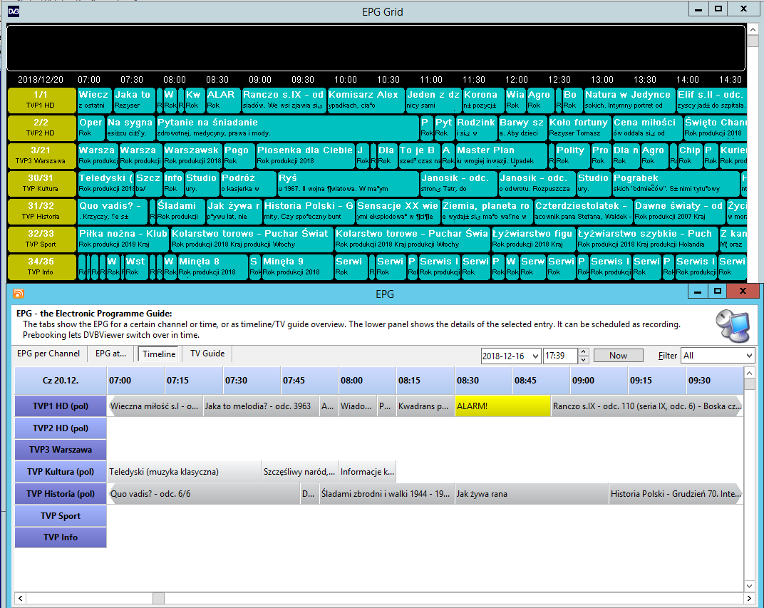

Alan_SP Posted December 17, 2018 Posted December 17, 2018 It looks like you have similar situation as is in my country. To see solution, check this thread: https://www.DVBViewer.tv/forum/topic/61419-epg-problem-sometimes-theres-no-epg-information/ Quote

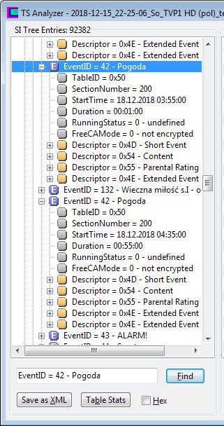

Griga Posted December 18, 2018 Posted December 18, 2018 P.S. There is something I can see already now in the TransEdit Analyzer. The broadcaster is using the same Event ID for different programs (or more to the point, for the same program at different times). This does not comply with the DVB specifications (Event IDs must be unique and unambiguous) and quite troublesome for software that does not just receive the EPG data, but stores it in a database. Read more about it here. TransEdit (see download area, it's similar to TSReader) just lists the arriving data and doesn't mind. But in DVBViewer it's a different thing, because it does a lot more with the data... Quote

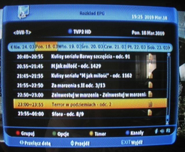

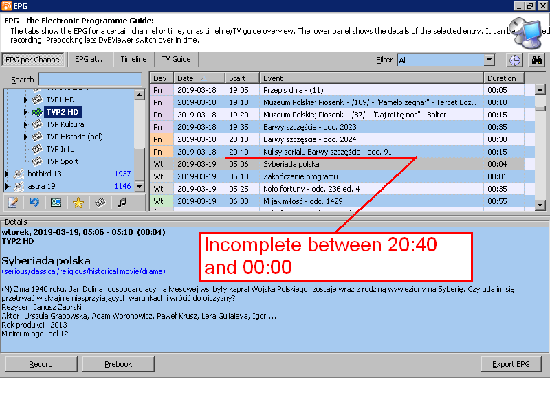

bonifacy Posted March 18, 2019 Posted March 18, 2019 Polish DVB-T MUX-3, TVP http://www.sat-charts.eu/dvb-t.php?mux=MUX-3 EPG is also often incomplete too. There are often a few hours of loss. 1. EPG DVBViewer, see pic 1 2. EPG Tuner Golden Media Spark_ONE_TRIPLEX, see pic 2 Quote
