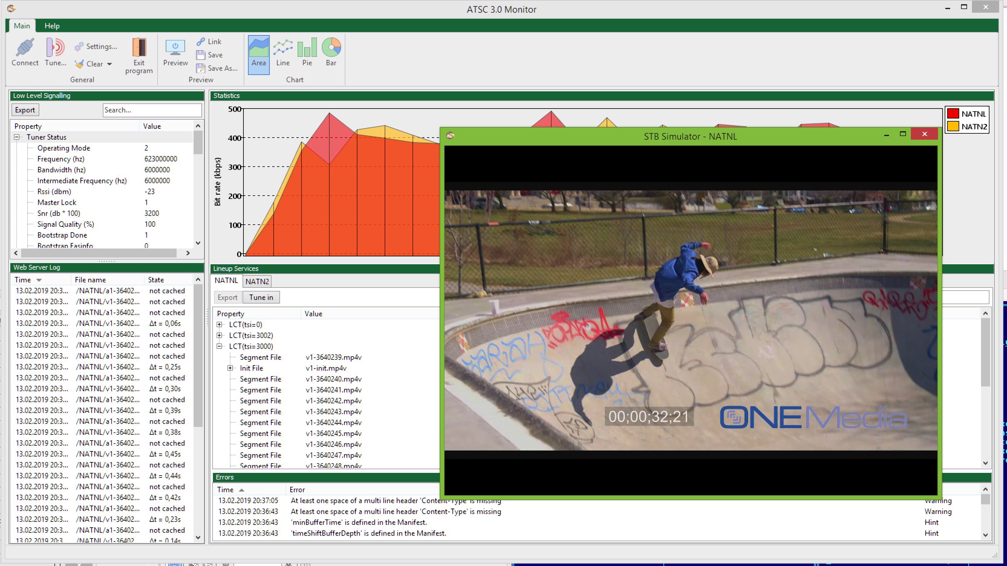

We indeed do work on ATSC 3.0. Technically it is except the medium which is used (terrestrial broadcast) not quite comparable to the original ATSC 1.0. I also know the author from ngbp.org and his GitHub projects. He has also a couple of recordings which can be used for testing: https://github.com/jjustman/atsc-3.0-mmt-pcaps/tree/master/2019-01-07-atsc3.0-587mhz.
I do have ideas how to implement playback in the DVBViewer, but till then there will flow a lot of water down the Mississippi.
