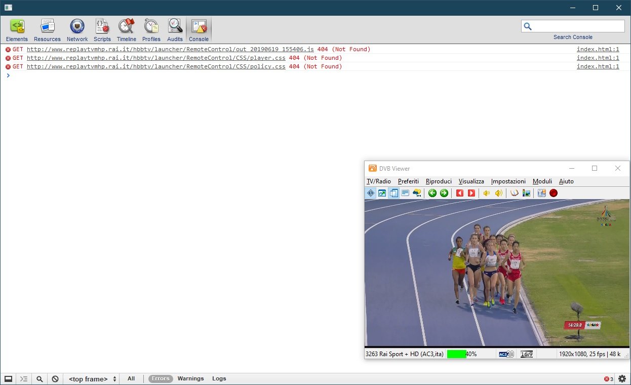

hackbart Posted July 8, 2019 Share Posted July 8, 2019 It should work fine, except that i can not play the video content. I see a request and get an error message in return. If you have general problems try to create a vbs file with the following content: Dim DVBViewer Set DVBViewer = GetObject(, "DVBViewerServer.DVBViewer") DVBViewer.HbbTV.LoadInBrowser "debug", 1 DVBViewer.HbbTV.Visible = 1 If you start this vbs file the DVBViewer opens a javascript debug console which shows the exact error(s). Christian Quote Link to comment
gusura Posted July 9, 2019 Author Share Posted July 9, 2019 I opened DVBViewer on raisport hd, created this vbs, run vbs and pressed f5 and made this screenshot. If i press f5 i don't watch browser but only channel. With das erste,zdf, .. hbbtv works right. Quote Link to comment

Griga Posted November 4, 2022 Share Posted November 4, 2022 I've lately tested the HbbTV add-on with channels from various satellite positions (including RAI on Hotbird) and found that it is only usable in German-speaking countries (Germany, Austria Switzerland). The main reason is the out-dated JavaScript engine, that doesn't understand new JavaScript syntax elements. Unfortunately there is not much that can be done about it. For more information see here. Quote Link to comment
Massietin Posted November 4, 2022 Share Posted November 4, 2022 Ok. So in that case we have to use the direct link from a browser instead of dbviewer, for italian Rai: http://www.replaytvmhp.rai.it/hbbtv/launcher/RemoteControl/index.html?delivery=2 Quote Link to comment
