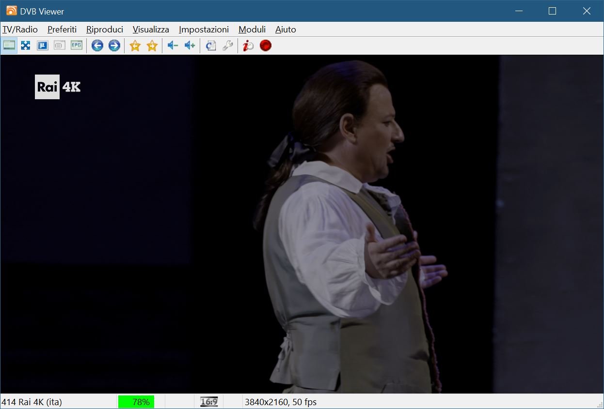

Marco Massari Posted August 11, 2019 Posted August 11, 2019 (edited) Hello, Congratulations on the forum, very useful. I,m a happy user of DVBViewer pro for years. I noticed a small problem. In practice with A***D I can seeing all the HD and UHD channels of the tivusat platform through a regular active card. I have only one problem in a channel called RAI 4k that although it is tuned and you can see perfectly fluid images thanks to the hardware decoding of my RTX 580. But now it seems that only in that channel DVBViewer does not detect the audio stream, so that it does not appear at the bottom of the program view, even the encoding symbol (it should be E-AC3). I tried changing the AC-3 decoder but nothing from the settings. Also changing PID and putting the format recognition in the settings changes nothing. As a decoder I have tried both LAV audio decoder and AC3 Filter. If you want i can put the transport stream where there seems to be the E-AC3 audio stream at PID 102. Thanks for anyone who can help me. Marco Edited August 11, 2019 by Marco Massari Quote

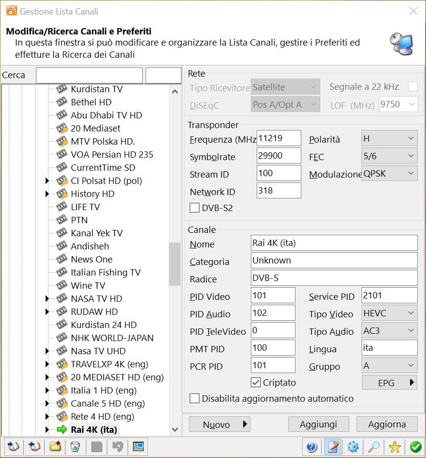

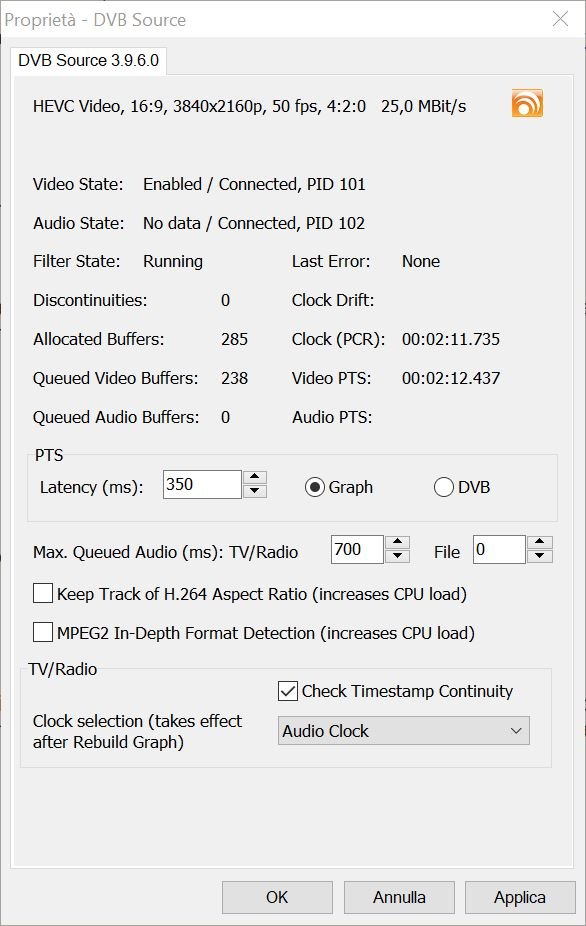

Griga Posted August 11, 2019 Posted August 11, 2019 Which Audio PID and Audio Type is shown on the right side of the DVBViewer Channel Editor for this channel? What does the DVBViewer Filter Property Page show if you play this channel? Please attach a screenshot. Quote
Marco Massari Posted August 11, 2019 Author Posted August 11, 2019 (edited) Thanks a lot. Edited August 11, 2019 by Marco Massari Quote
Griga Posted August 12, 2019 Posted August 12, 2019 As far as I can see the Audio PID and Audio Type in the channel list are correct. However, according to this site parts of the reception data seem to be wrong: FEC should be 3/4 Modulation should be 8PSK DVB-S2 should be on. But I don't think this is the reason for missing audio, because you are getting video. Most likely your DVB hardware is able to detect these parameters automatically. So I guess your decryption system doesn't decrypt audio for some reason, indicated by "Audio State: no data" on the DVBViewer Filter property page (which actually means "no usable audio data"). Quote

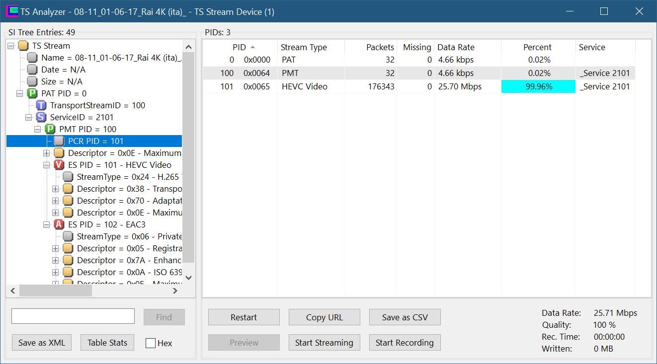

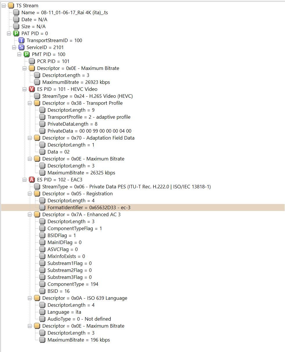

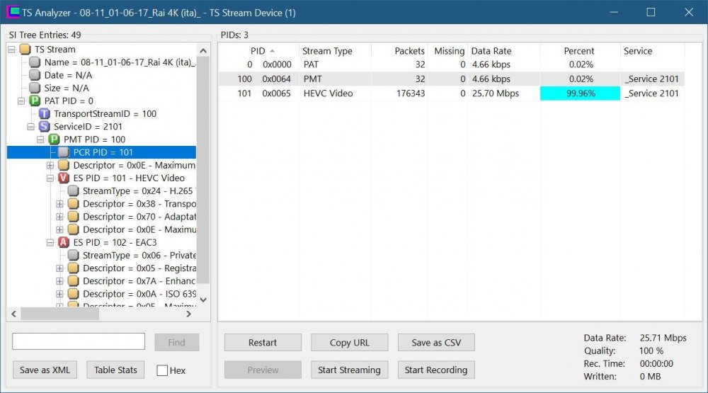

Marco Massari Posted August 12, 2019 Author Posted August 12, 2019 Thanks. I tried to record a clip and with TransEdit I get this. See channel problems? Quote
Griga Posted August 12, 2019 Posted August 12, 2019 It looks ok. But that is SI (Service Information) data read by scanners. For playback it is not so important. Does the audio stream with PID 102 appear in the PID List on the right side of the Analyzer window? Is it displayed in Red or Black? Quote
Griga Posted August 12, 2019 Posted August 12, 2019 4 hours ago, Marco Massari said: It does not appear. This means, no audio stream is present. Obviously you are not receiving the original channel via satellite (Hotbird), but an internet stream. So it may be a server side problem. Quote
