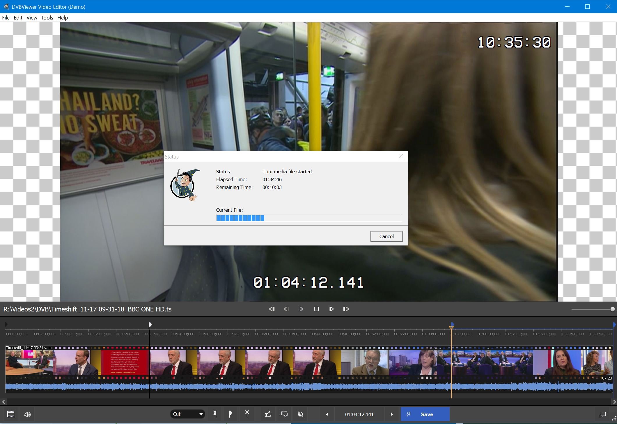

Tried video editor for the 1st time (64 bit version).  Been stuck on time remaining for about (10:03) 1 hour. Is this a known issue?
Trying to stop programme via the red X does not work while it is in this state. Will have to end via Task Manager.
It might stuck if there are problems in the stream. The editor engine is quite sensitive when it comes to things like this. You should check the "obey sample times" option. You might also remove the indexing file before opening the video. If everything does not work, select "Use ffmpeg for trimming".
