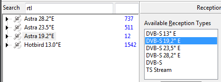

After a DVBViewer restart almost all 19.2 channels where gone ecept 12 channels (Picture-1).

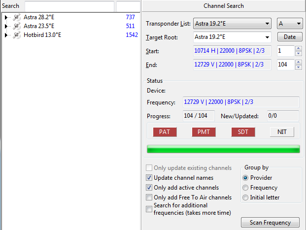

I did a new scan on 19.2 but no channels where added and only found 12 new. (Picture-2)
I deleted the whole 19.2 channel list and did a clean scan from scratch. (picture-3)
As you can see no channels no updated channels where found.

The channels on the second screenshot are from Astra 28.2°E, so obviously switching to Astra 19.2° E (DiSEqC) did not work.

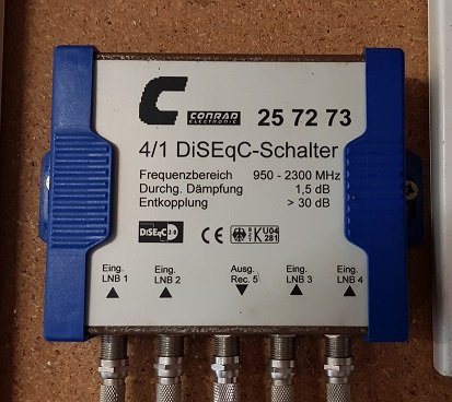

It could also be an outdoor equipment failure. Which kind of switch / dish are you using for receiving 4 satellite positions?

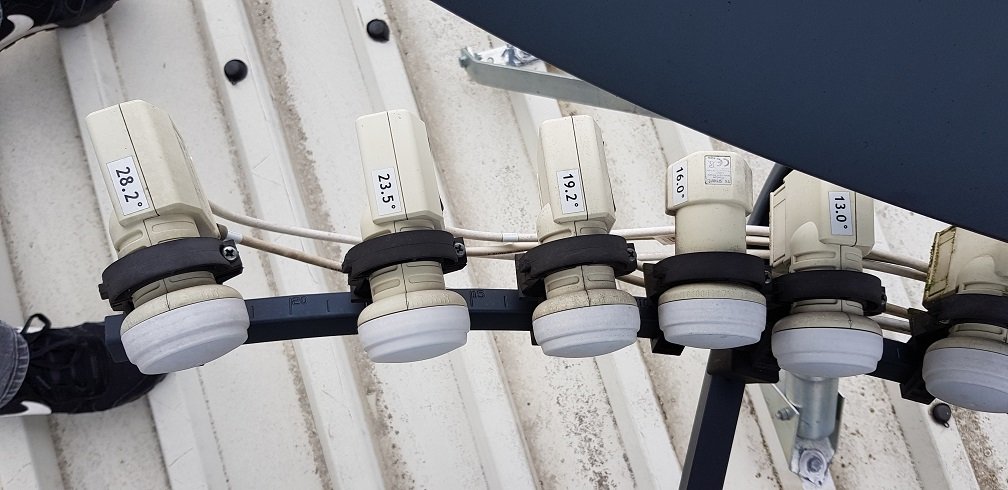

I use a 4 port Diseqc switch with a WaveFrontier T90 dish:
This is the dish but I use only 4 LNB's on 13, 19.2, 23.5 ,28.2° with dual output:
Finaly I figured out the problem.
It was a defective Diseqc switch, I replaced it with another one just for testing and BAM Astra 19.2° was working :-)
