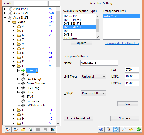

Just use the channel list for Astra 28° East that is installed with DVBViewer 6.1.7.1: TV/Radio ->  Reception Settings/Channel Search -> Select "DVB-S 28.2° E" as reception type (or, if not available, "DVB-S" and a transponder list for Astra 28° East) -> Adjust DiSEqC if necessary -> Click "Load Channel List". That's how it looks like:
The first E4 entry is from 10714 H. It works here without problems. The second is the encrypted one from 10936 V (it wasn't encrypted when the channel list was created, that's why it is not flagged as encrypted). It doesn't work. E4+1 from 10936 V is unencryped and works.
