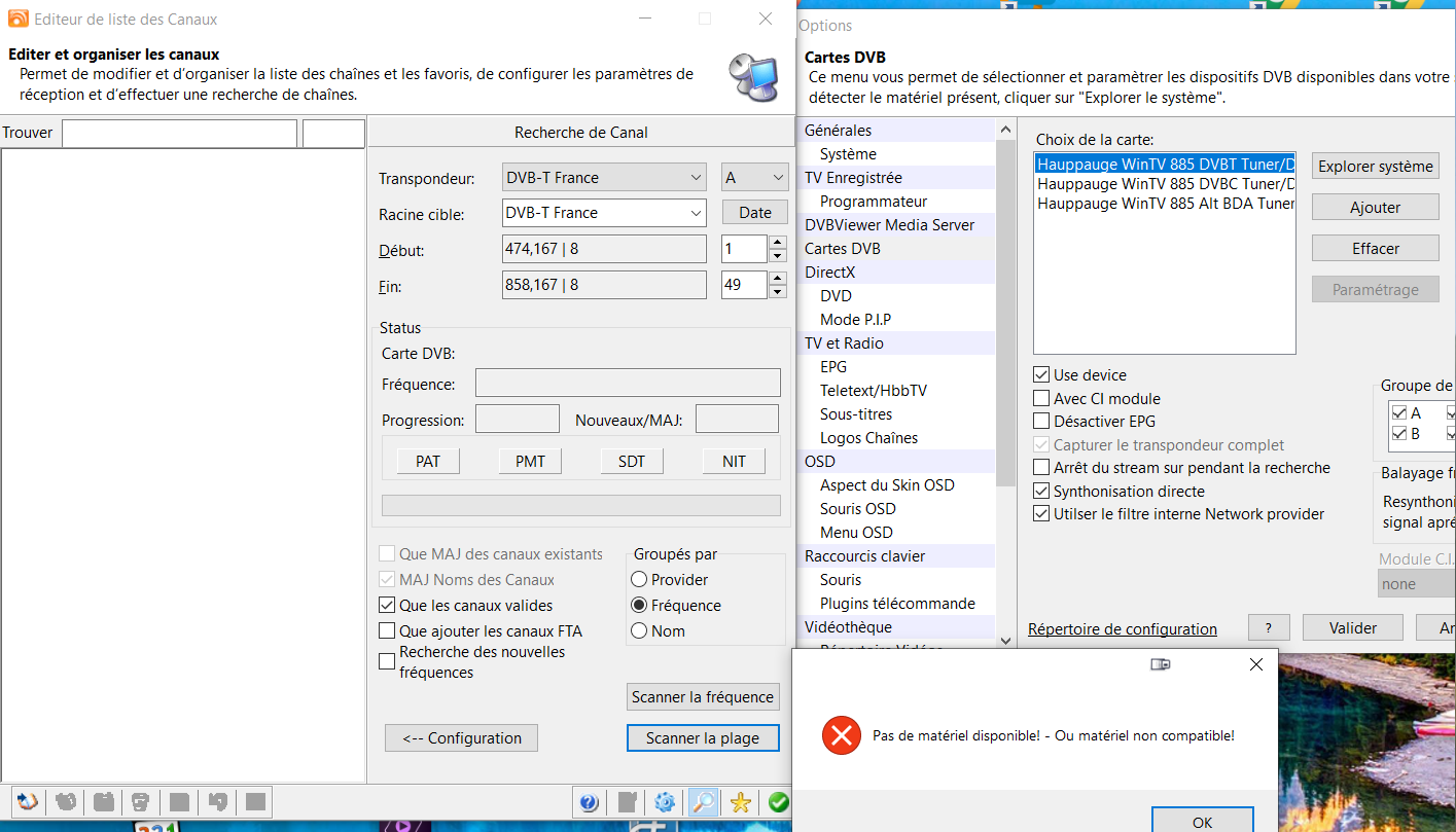

claude dautheville Posted December 15, 2020 Posted December 15, 2020 hello, the card is recognized by windows 10 but not run in DVBViewer . i attach 2 files . support zip and DVBViewer error. thanks for your help. claude support.zip Quote

Griga Posted December 16, 2020 Posted December 16, 2020 It's some error on the driver level or in the Windows BDA sub-system: Quote 15.12.20 22:41:32.509 TBDAHauppauge OpenDevice Hauppauge WinTV 885 DVBT Tuner/Demod (1) did not start: bvHauppauge 15.12.20 22:41:32.531 TfrmScanner AllocateHardware Open failed What I would do: Check if Hauppauge provides a more recent driver that fixes issues under Windows 10 2004 Uninstall and remove the current driver in the Windows device manager Reboot Install the driver again (or a newer, if available) Remove the file hardware.xml from the DVBViewer configuration folder in order to force recreation and re-detection of tuners Launch DVBViewer and try... good luck! Quote
claude dautheville Posted December 16, 2020 Author Posted December 16, 2020 Hi. I have install new drivers, reinstall DVBViewer unplug, replug card in another slot and the problem is the same. Perhaps the card as a problem. Thanks for your help Quote
Griga Posted December 16, 2020 Posted December 16, 2020 Does the Hauppauge TV software work? If you have already installed the Hauppauge TV software, a background process may occupy the tuner and temporarily prevent DVBViewer from using it. The issue may also be caused by a damaged Windows BDA sub-system. There were already similar reports in the past. In some cases a Windows 10 repair install has fixed it. Quote
claude dautheville Posted December 17, 2020 Author Posted December 17, 2020 Hello i have downgraded the os version and the problem is solved. Thanks for you help Quote
