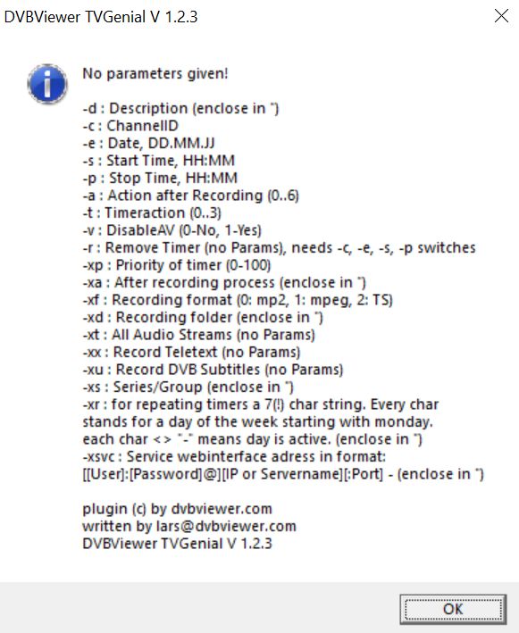

Ich habe mal einen Screenshot der Parameterausgabe von dvbv_tvg.exe gemacht und durch Tesseract (FreeOCR) zu Text umgewandelt.
Zitat
No parameters given!
-d : Description (enclose in ')
-c : ChannelID
-e : Date, DD.MM.JJ
-s : Start Time, HH:MM
-p : Stop Time, HH:MM
-a : Action after Recording (0..6)
-t : Timeraction (0..3)
-v : DisableAV (0-No, 1-Yes)
-r : Remove Timer (no Params), needs -c, -e, -s, -p switches
-xp : Priority of timer (0-100)
-xa : After recording process (enclose in ')
-xf : Recording format (0: mp2, 1: mpeg, 2: TS)
-xd : Recording folder (enclose in ')
-xt : All Audio Streams (no Params)
-xx : Record Teletext (no Params)
-xu : Record DVB Subtitles (no Params)
-xs : Series/Group (enclose in ')
-xr : for repeating timers a 7(!) char string.
Every char stands for a day of the week starting with monday.
each char < > '-' means day is active. (enclose in ')
-xsvc: Service webinterface adress in format:
[[User]:[Password]@][lP or Servername][:Port] - (enclose in ')
plugin (c) by DVBViewer.com
written by lars@DVBViewer.com
DVBViewer TVGenial V 1.2.3
